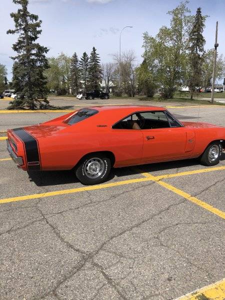

I'm looking for suggestions on a wheel/ tire combination for my Charger. I currently have the stock rally wheels and 215/ 70/ 14 tires. I am looking for an attractive staggered combination that will improve drivability and fill out the wheel wells in the back. The car has 3:55 axle ratio so a bit of "overdrive" would also be welcome. Car currently runs about 3100 RPM at 60 Mph. If you have a 2nd generation Charger with a nice combination, please post a photo and note the wheel/ tire size for comparison.
I am planning on keeping the stock wheels and mounting the Goodyear Polyglass tires that came with the car for the purpose of car shows, etc.

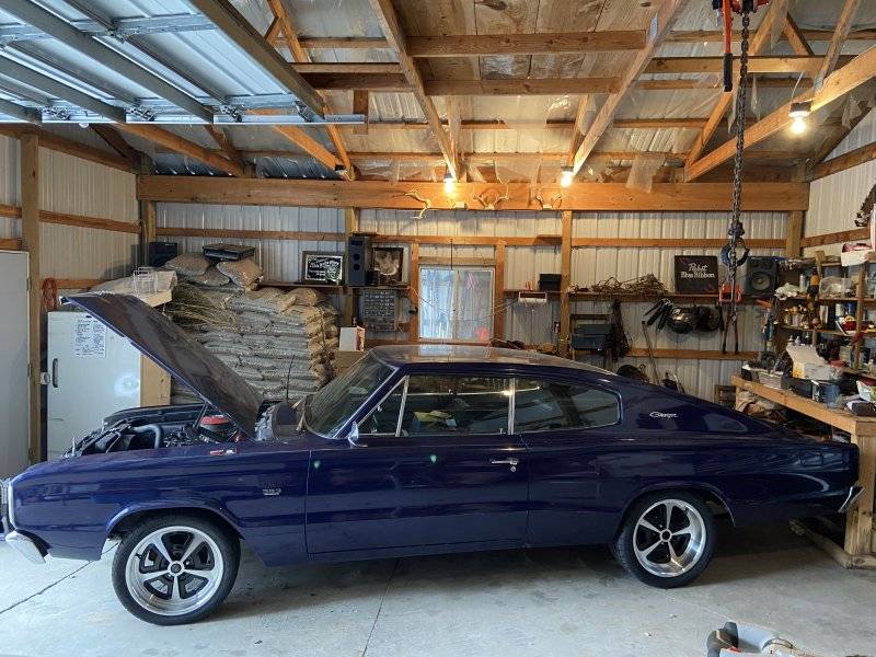

Not my cars, unfortunately I don’t own a charger, but I thought I would give an opinion if that’s ok. 15x7, 235 or 245/60/15 front, and 15x8 with 275/60/15 is pretty much the standard. Fills up wheel wells nicely, and if you’re brave enough 15x10 with a 295/50?/15. You’re lucky, any wheel looks good on a charger, but here’s some of my favorites.
American racing vectors, of course we all know the famous car these were on.
American racing daisys. I think they’re more common on Chevys, but I like you don’t see them too much on mopars, makes it stand out IMO.
