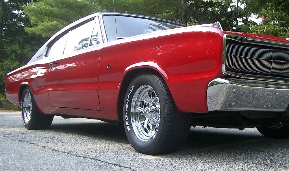

You didn't mention what the car was? Mines a 69 Charger, zero offset all the way around with 10 wide rims in the rear and 8 in the front. I've got 11" wide tires outback with enough room to go bigger (295s at least).
Rear 295/50/15 on 15X10 Cragar Street Pro 390 with 5" BS (-12mm offset)
Front 235/60/15 on 15X7 Cragar Street Pro 390 with 3.5" BS (-13mm offset) Would use 15 X 8 next time around.

Hey 67mopar, will your rear tires clear the lip on the rear wheel well if the car was sitting a bit lower?
Yes... it's a 14" opening with a 12.5" wide tire sitting in the center of it.... which leaves adequate clearance for bounce, or when lean into the corners. All cars are not necessarily the same however. There can always be small differences that might matter in the end, so I always recommend that careful measurements be taken beforehand.... you never know.

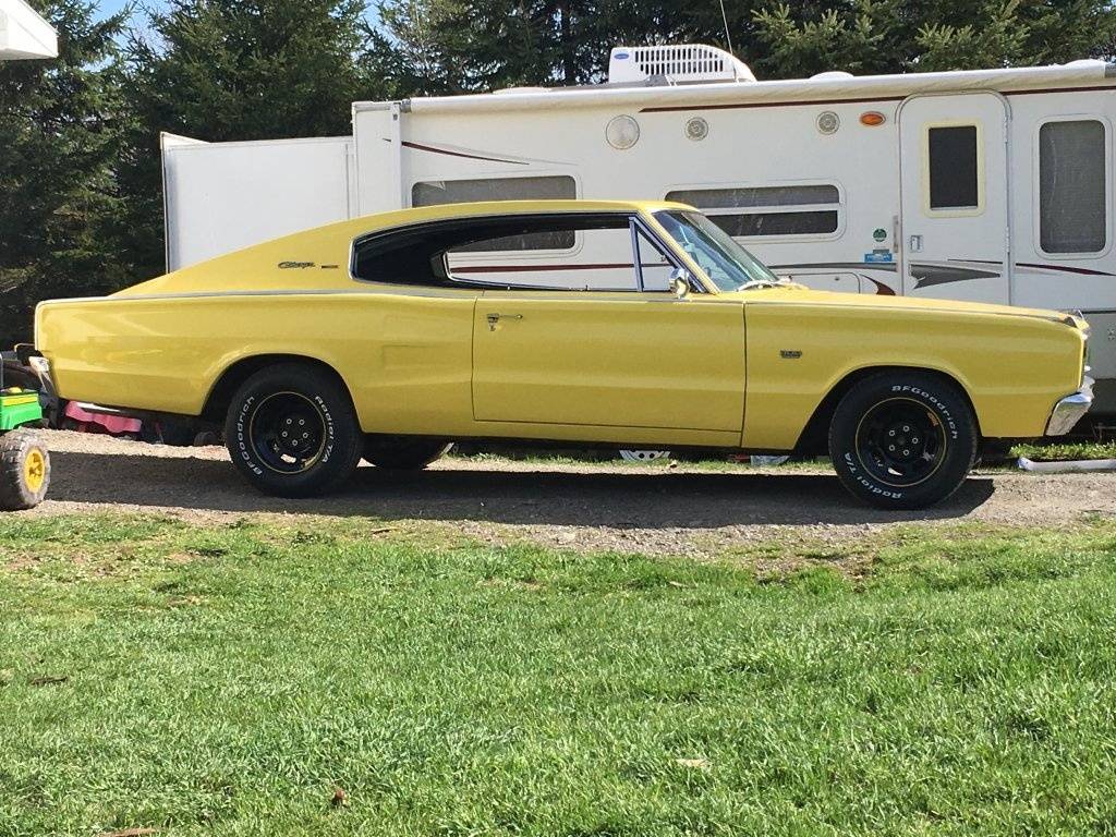

I ended up going with all 8 inch rims with a 4 inch back space on all. 255/60 in the rear and 235/60 on the front.
