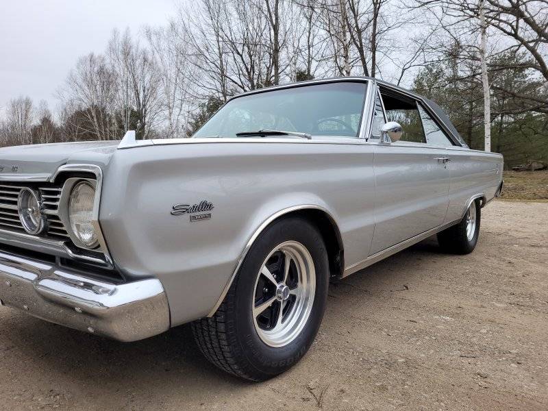

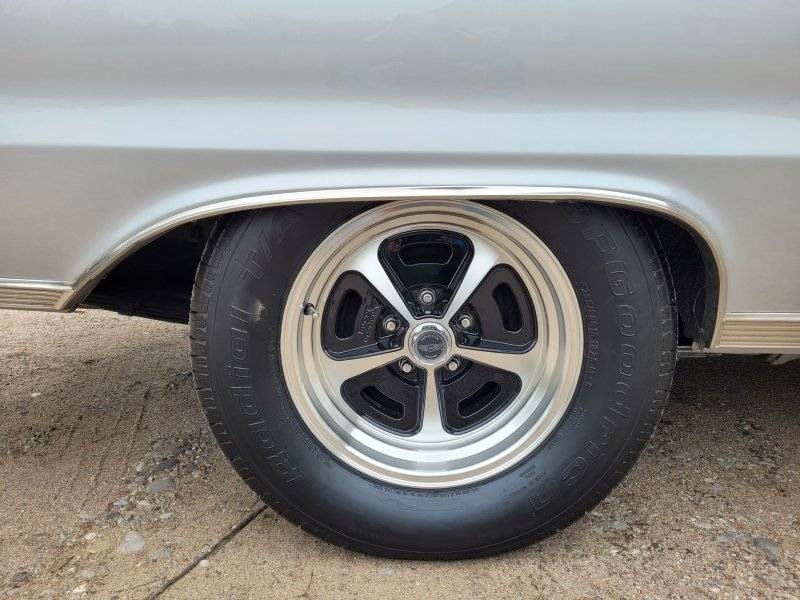

I have 225/70R15's on the front of my '66 Satellite and 255/60R15's on the rear.
