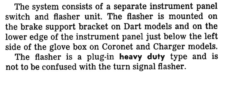

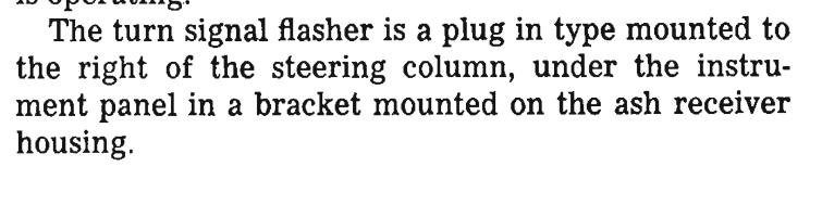

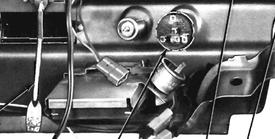

From the 1967 service manual:
Turn signal flasher:
Emergency flasher:
