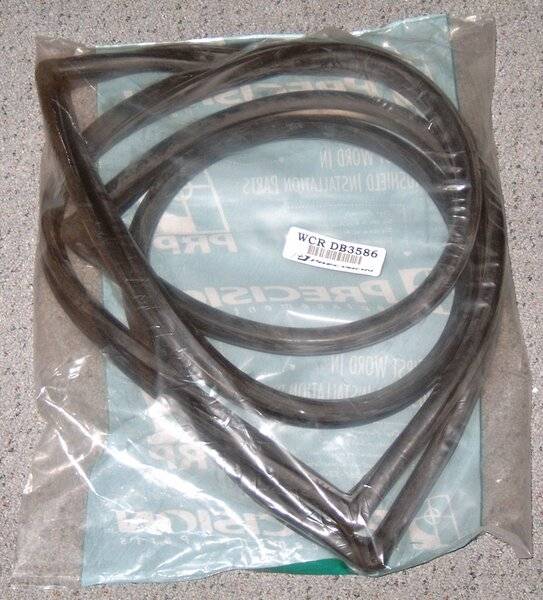

I had both windows done on my Charger at one time, front replaced and rear removed, cleaned channel, fixed clips and replaced with new gasket. My glass guy would only use Precision so that is what I ordered.
I had both windows done on my Charger at one time, front replaced and rear removed, cleaned channel, fixed clips and replaced with new gasket. My glass guy would only use Precision so that is what I ordered.View attachment 988129
From what I was able to learn, the Precision WCR DB 3586 gasket is manufactured by Steele and sold under the Precision label.
I have one coming with a YearOne label made by Steele. Some sources say Steele is the only manufacturer of the 66-67 Charger rear window gasket.
In the end, if it fits, I'll be happy.
