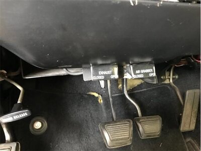

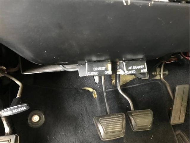

I am trying to see if anyone has seen this bezel before? It looks just like the Air Grabber bezel on the dash of 71 bodies but it’s for exhaust cutouts. Thanks.

Custom made. Probably a decal over any other bezel. Font is not the correct one, just pretty much similar.
Bezels available I can recall right now are just for headlight washers ( just option for Chargers with hideaways ), rear deffog, rear door ajar ( SWs ) and air grabber/Ram hood (depending if Plymouth or Dodge)

I guess if the exhaust cut outs added in that car are vacuum like GTOs, an air grabber switch could be used too since it gets just two positions to open or close for the vacuum setup ( I think can see a vacuum hose on back of the switch on pic ) The rear deffog gets three... off, low and high. I can't tell about SWS rear doors switch.
