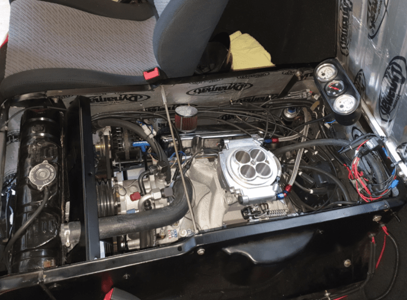

On 4 diff hotrods , I have mounted it on the pass. fender , as close to the dist. as possible , also a hair cooler there than on further back , or on the firewall. On a big block it would take an extremely long coil wire if mounted in the car --------------jmo

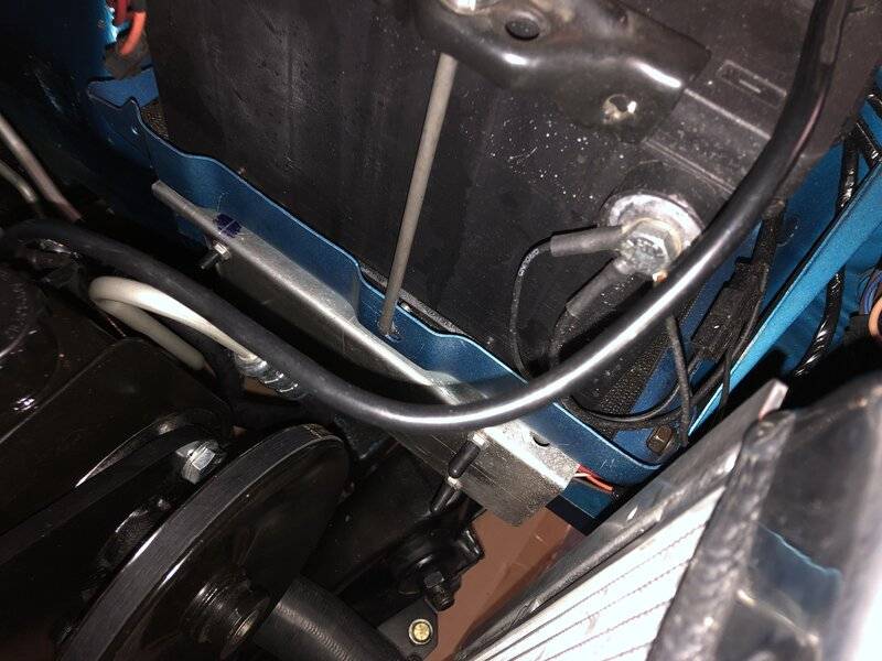

Sniper user here. I put the ignition box under the battery as well but I made a mounting bracket for it. Obviously can't see it behind there but it faces forward so the connector is facing front. You can see the wires poking out a little.

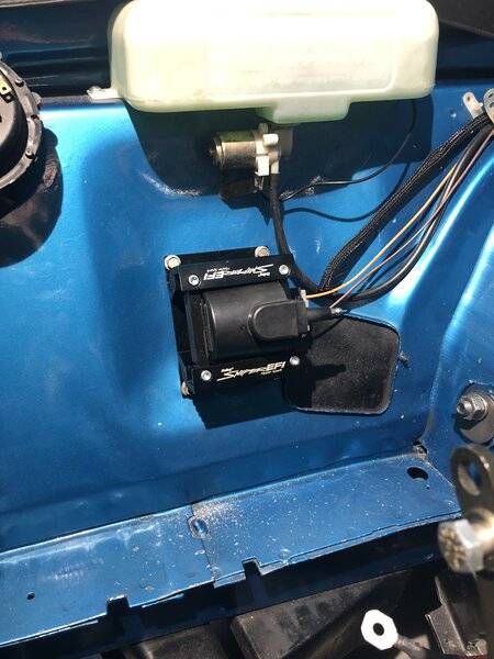

I put my coil on the passenger side inner fenderwell.

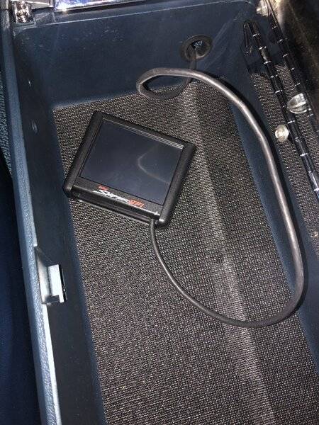

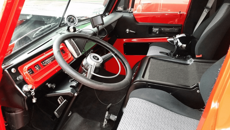

The handheld lives in my console.
