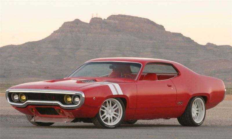

Hi guys....
Just wondering where you find Amber high beam lights like in the attached pic..... I love the look and would like to change mine out.
Thanks
have mine on the high beam circuit witch is a two prong bulb so the Wagner 4412A fog light has a different setup for bug connectors and screws so I just unsoldered the terminals from my regular high beam and resoldered them onto the fog lights .worked like a charm
Phillips used to make a line of colored lens bulbs called "Color Clear". I don't think they make them anymore. They even made red and blue for ambulances and such. I bought a pair of "black" smoke rectangular ones for my old Mirada and liked them very much.
I live in Michigan, so I converted my 65 Coronet to all halogen lamps by rewiring and feeding them through relays (2). I want to see the GD deer before I hit them.
Mike
Just wondering......the high beam bulbs are two prong but the amber bulbs above are three prong, will they still work if you only plug into the two prongs with the three prong plug ?
NO!!!!!!!!!!!!!
I bought mine at O'reilley auto parts
sorry, I mis-understood your question ! if the ones you have now work, take them out and paint them.
just clean good with alcohol, get a can of Krylon stained glass paint ( yellow ) from Hobby Lobby, several light coats until desired color is achieved
