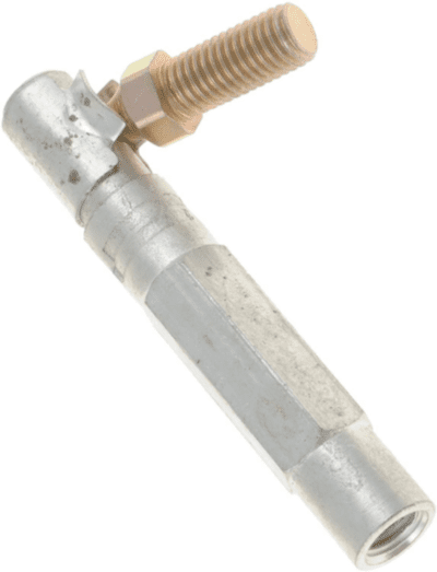

While removing the valve covers and throttle linkages for powdercoating ,I lost the ball clip for the kick down linkage .
I've looked at a number on line catalogs and am not able to find a part number .
I also want to replace the washed out valve cover rubber gaskets that the hold down bolts go through .
This is for the Poly head valve cover .
Any help would be appreciated
What do you mean by ball clip? If it's anything like this you can get throttle linkage balls from Dorman (this particular part is #115-002)
