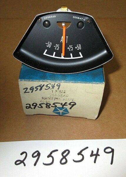

Thanks Nacho, I have found quite a few NOS units on Flea bay , but appears they will all need to be custom fitted to my Rally cluster. If this is my only option , what do you think about the 80 amp meter made for police cars, found one of those......
that would be a nice idea IF your cluster is with the ammeter pointing up ( non tach or clock )

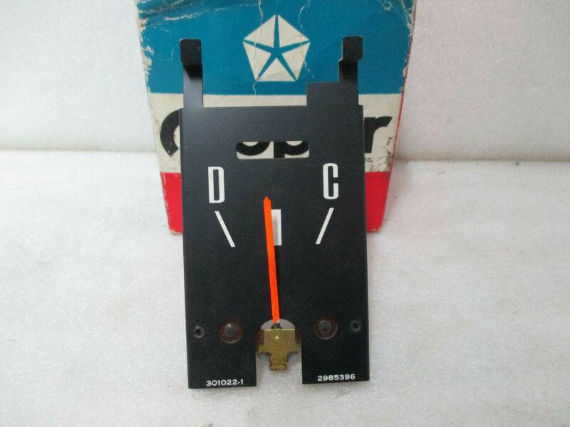

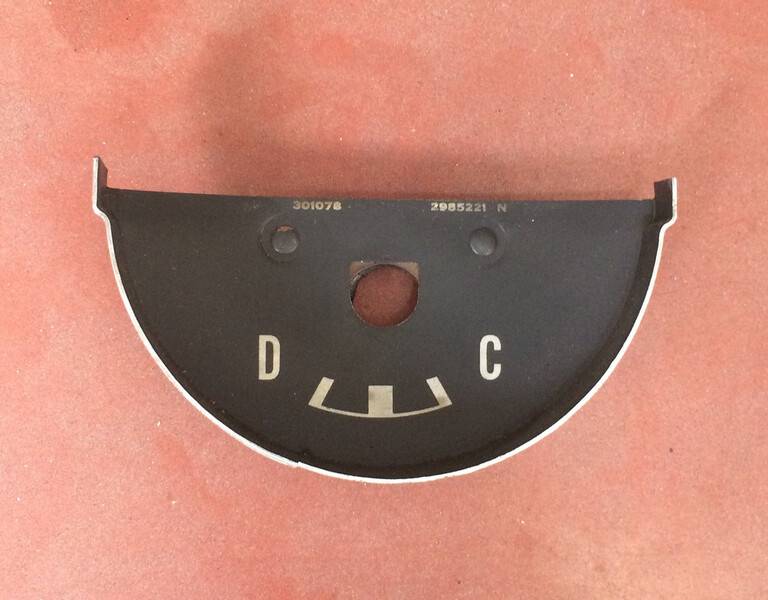

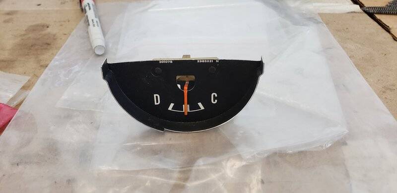

Myself, I have this extra face from a cluster I got with a virtually destroyed ammeter ( somebody damaged trying to remove it in the past )
and pretty sure I could make fit that face on this ammeter
the gap between rivets seems to be the same.
and ACTUALLY I'm positivelly thinking the only diff between diff ammeters is just the face, the needle index and lenght ( I can see this would need some reshaping too, due the diff opening heigh if you can meet the rivets location ). Aside the magnet calibration ( 40, 50, 60 or 80 ), but I meant phisically.
I must say I NEVER HAVE MADE THIS ( so please don't take my word as a rule! ), but I think is doable. Is about match the face height and studs

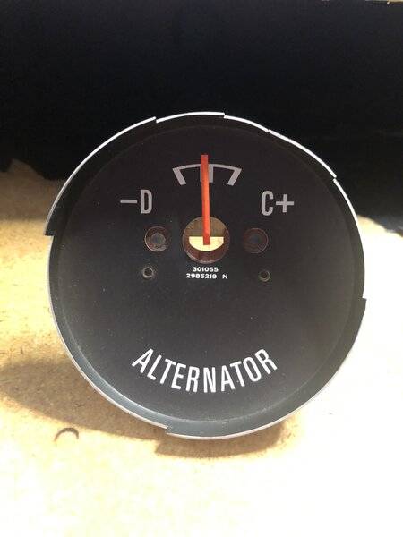

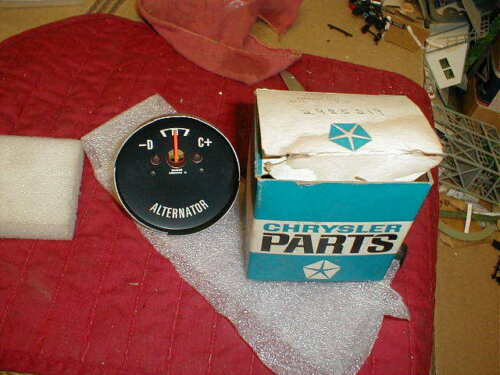

now, if your Rallye cluster is the standard one with the gas/oil gauge into the big opening at a side of speedo you use this ammeter with needle pointing up:
( yes, I know, $195 from hiltopap. For a bit more you get a full cluster )
and get this one made to fit into back of the face, as mentioning, trimming the needle. Rivet gaps should be also about the same

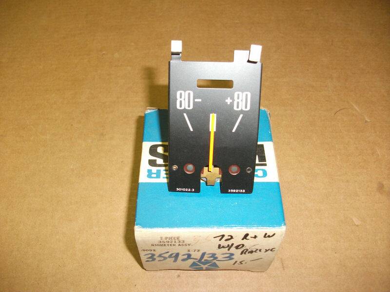

Or even better, an 80 amps one as you mentioned
HOWEVER, must to say the only difference will be the needle calibration by the magnet on back, but studs are NOT reinforced to the load. They are built exactly the same than 40 amps ones.

Thanks Nacho, mine is a standard Rally, no tach of clock. So I think you are saying that my original meter had the needle pointing up, and that is what I should be looking for. Will look at some old clusters and new OEM units and decide which route to go......
From the distance that one is easier to find and also to make the face change using the standard cluster one.
I did the same untill get the parts to build a non fixed Rallye kilometer speedo. Hence the reason I have some extra parts too ( minus the amm, but just the face on pic)
