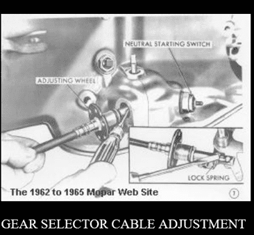

Mine had a rip in it about 2-3-inches long to the bottom fitting. Repair likely would have lasted longer if I didn't have to adjust the wheel. Kind of a bitch of a job as you have to hold the wheel true flush to the VB while rotating the wheel to get the proper adjustment while your partner keeps pressure on the R button...one of those chores where a 3rd hand would be nice...

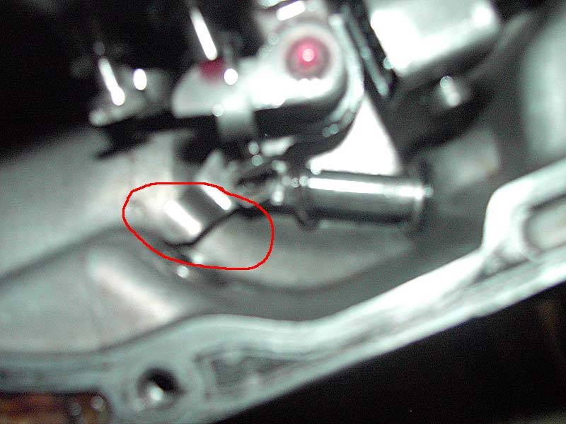

I am trying to adjust the new shift cable at the transmission end and need to know what position they mean when they say it should be locked into the reverse detent position when you set the wheel and put in the lock screw. Is the reverse position when the lever and cable are pushed into the trans as far as they can go? Or is it one of the positions in between? I assume it is all the way in because they say to push in on the cable until it is in the reverse detent position.
Also, if it ends up that the o-ring on the end of the cable sleeve is all the way into the cable hole in the trans won't it leak like crazy? Not sure if that will be the case but it sure looks like it might be

If I follow your question, ual of this if you've not done this before
I goofed up with the reply due to lack of space. You should have a visual if not done this before. You need a helper to hold the reverse button in while you insert/adjust the cable. I'd actually prefer another down below to just steady the cable; but can do alone. Make sure the wheel is backed off exposing a half inch or so of threads (assuming you have inserted the cable end). If the cable is seated and the wheel doesn't come near to the valve body then rotate the wheel clockwise so that it is near to flush. You want to make sure the wheel isn't cocked so ya hold the cable in position to do this to achieve a flush contact with the VB while you rotate the wheel to seat flush to the VB. Once the wheel is seated flush rotate the wheel clockwise to nearest hole...then while holding it in position...rotate the wheel counting next four holes to align for bolting in. Insert bolt - be careful - this is aluminum - do NO
Ok, having some posting issues...to continue, don't overtighten the bolt as it can be stripped ahhh...I know. It's likely this bolt has been in and out many times for adjusting if tranny hasn't been refurbished, spec's say torque to 75-inch lbs. I do a bit less. Make sure the O-ring is seated and add some lubrication to threads and ring before seating it; but could already have tranny oil in good quantity if oil hasn't been drained or you're installing a new cable.

I understand the main instructions from the service manual, my question is really just for the lever that the cable attaches to in the VB which position is reverse? Is reverse when the cable would be pushed into the VB as far as it goes? In other words the lever would be pushed all the way towards the rear of the tranny?
Thanks
Attached is a pic (yes it's blurry but I think you can see what I mean). The lever circled in red is the one that the shift cable pushes or pulls. I just need to know to the correct position for the reverse detent is with that level pushed all the way to the left as seen in the photo. Thanks!

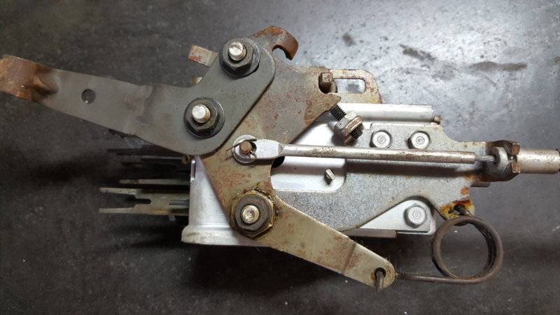

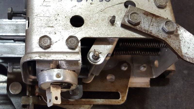

When trying to figure out why the park lever was floppy I found a broken spring up under the dash on a ledge. It is the spring for the park lever shown in your image. Does anyone have one of these they would part with or know where I might get one?
I figure while it is apart I might as well make it right
