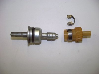

Yes, '68 Camaro fits the later, bigger 727 and 833 speedo drive. Perfect length, too. Not sure what your '64 has. Can you get a pic?
The '62-'65 speedo cable end is different than the '66-later.
