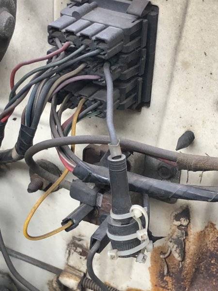

I need to replace this fix a garage must have done before I bought the car in 2004. I’d like to get one with the ring connector on the end like this Ford part. But I need 16 Ga. Does anyone know where to get one? Thanks!

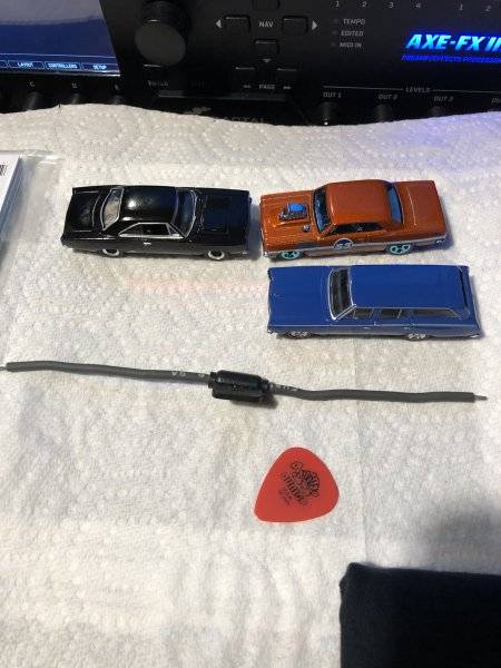

I do have this that I could have put ends on. The stud on the Mopar relay is 5/16. It helps to measure!
