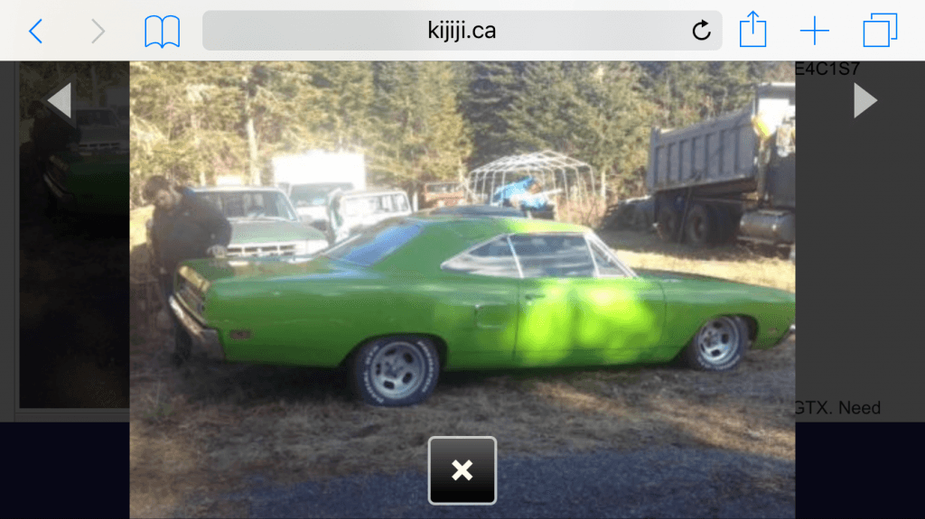

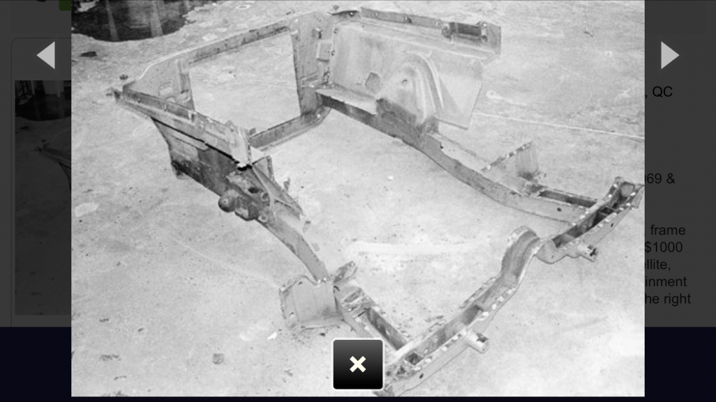

hey guys, my front frame rails are bad and the torsion bar cross member! So I picked up a complete front clip, rad support to torsion bar cross member from a non rusty donor car. I am not sure how I am gonna get everything strait? What should I replace first, the floor or the front section?

My problem is it is all one piece! Would be a lot easier if it was all separate pieces I think!

Here's one idea, make a jig to bolt in like the k-frame to keep the rails square, maybe a brace for the hinge area on the inner fenders too, remove the crossmember and get it welded into the car, then slide the rest into place. The crossmember sits on top of the inner rockers, so it's almost impossible to get it in in one piece, and it's only 8 spotwelds per rail to drill out. Take your time with a spotweld cutter and wd-40 to cool the bit. I highly suggest Blair cutters, they've done me well.
