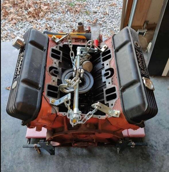

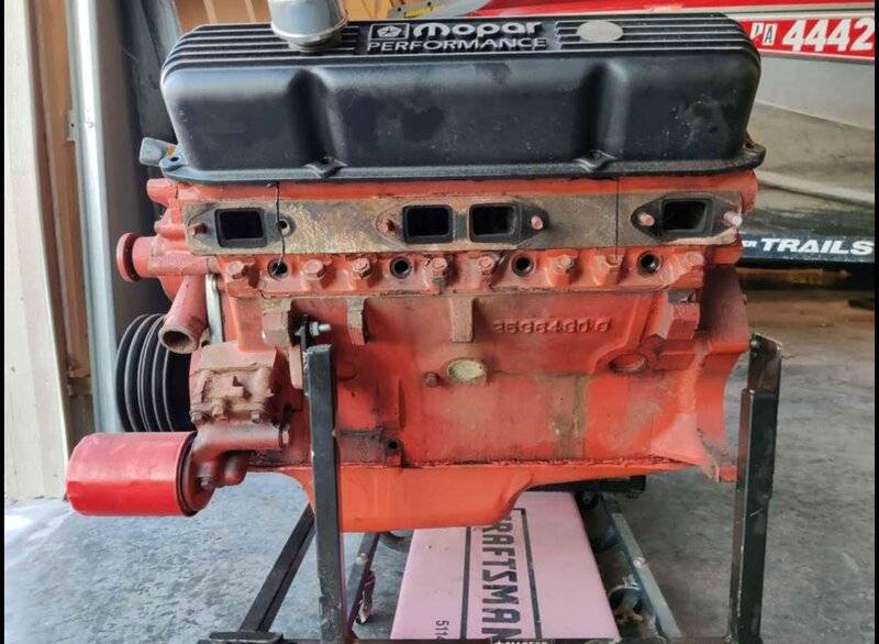

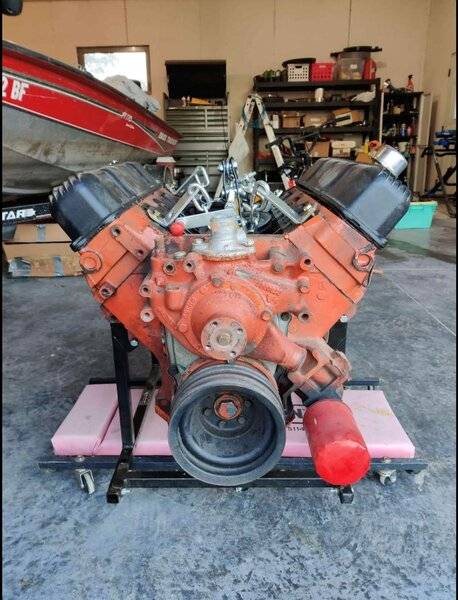

Potential Motors as of right now.

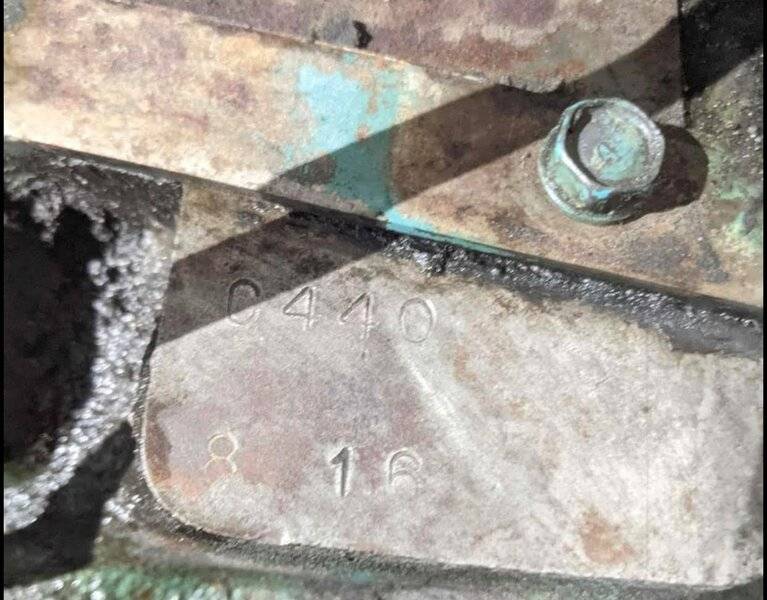

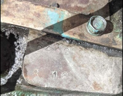

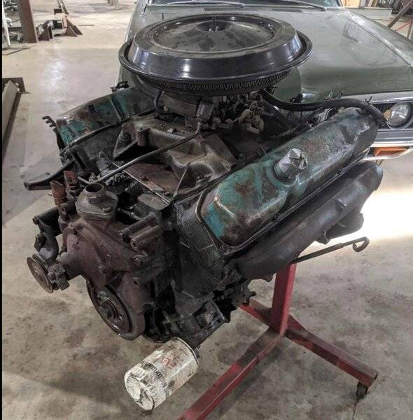

• 1968 440. (apparently it is an HP motor). It lost a bearing, but was still running when pulled. Motor work is unknown, but has a cam and newer timing chain.

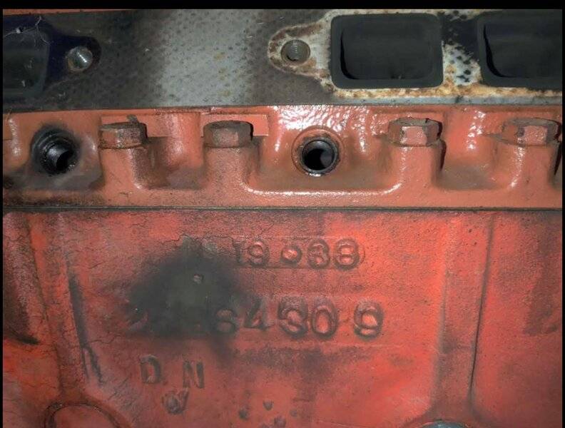

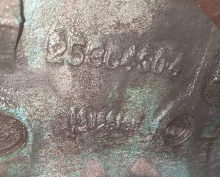

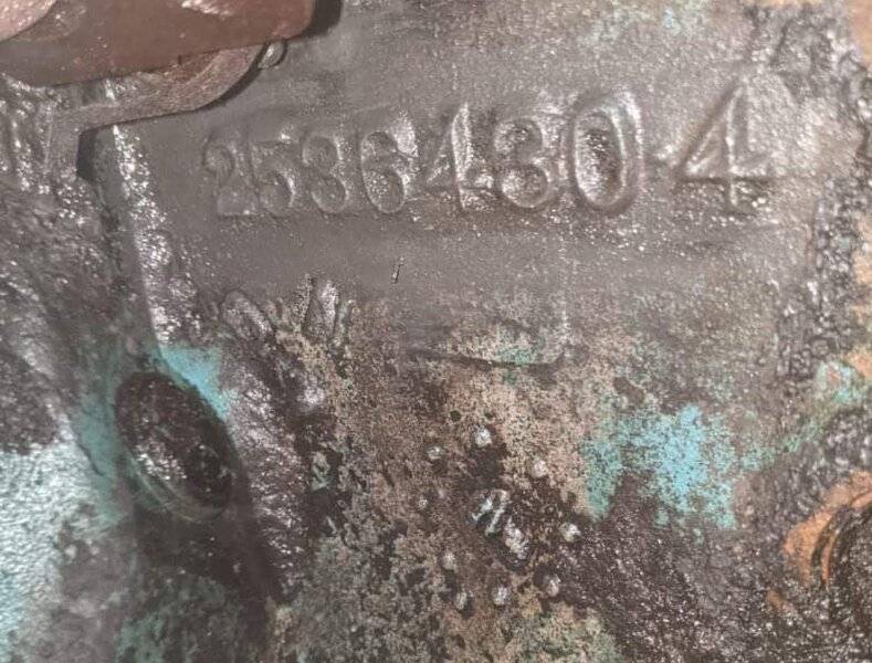

• 1967 440. Complete. Been sitting in a heated shop since the 90’s and spins freely. (Casting numbers are somewhat hard to read, but was noted as a ‘67).
• 1968 440. Bare block, with caps. This has some pitting on the cylinder walls and is recommended to go .030 over, possibly .040. It’s currently sitting at another engine builders shop, and has been tanked/shot blasted.
• Keep looking for another option
I have an Edlebrock RPM Performer Intake with the valley pan and gaskets, Mancini Water pump and housing, Mancini oil pan kit that came with the Melling Oil pump, and misc gaskets for a full rebuild. All those parts are brand new. I also have a forged crank, and all the other parts off of my old motor. Which all checked out fine, however, it has a 76 casting date. (I got the forged crank a while back to replace the cast).
Pictures below are of the 1968 and the 1967.
The bare block is not pictured.
What are your thoughts?

All this depends on the amount of wear and defects found in each. You want the best block that needs the least boring. The more standard the better.
My personal preference would be the 67 engine. If unmolested it's got the best heads IMO. This is the motor I would tear down first and if its good for building, I would go no futher.

Thanks. After re-reading what I wrote, it seems pretty obvious that the '67 would be the better candidate.

A '67 440 block is just fine. A later '68 block has the ribs between the freeze plugs, little better? Look at the heads and see what the casting numbers are. A '67 can have several versions of heads. The '68 looks like an early '68 block without the ribs between the freeze plugs, same as a '67.

The 69 and up blocks had strengthening ribs, but as stated, for a mild build I wouldn't worry about them. The HP and HP2 stamps were just that, stamps, same block.

I would likely to with the 1968 engine. Although it obviously would not have a matching VIN to your car, at least it is a 1968 block, same year as your car. The block would be stamped D440, and have 1968 casting date. It sounds like you have a good steel crank out of your cracked engine and may be using aftermarket heads and intake anyway. In real life, nobody notices these details anyway at the type of car shows and cruise-ins that most of us attend. It is mostly at resale that these concerns crop up. I bought my 1967 R/T without a powertrain, and purchased a 1968 440 with a 727 attached out of a junkyard New Yorker. I had it built to Magnum specs. It has been in the car for over 30 years, and no one has ever made a fuss about having the wrong year motor in my R/T.
