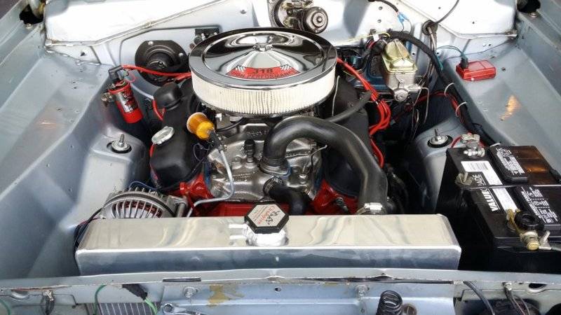

I have a speed cooling 22" rad which I have no issues with.
Looks good and keeps things cool where the original did not.
