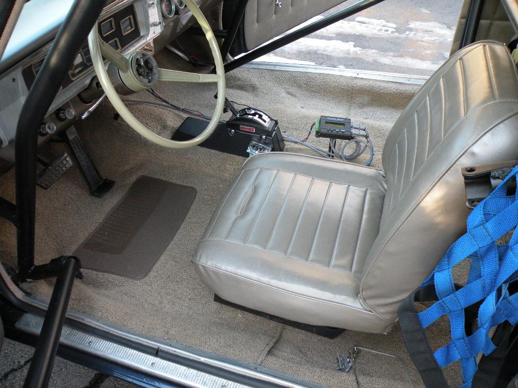

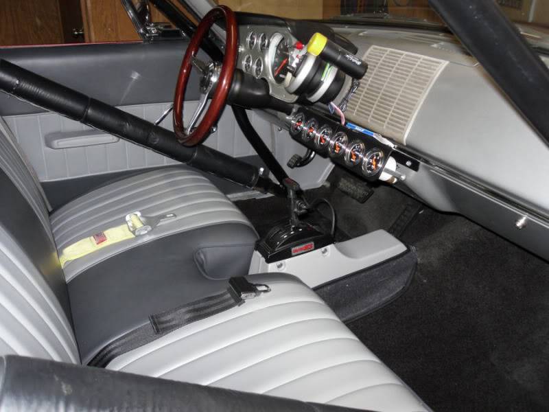

i like this one. turbo action cheetah shifter SCS.

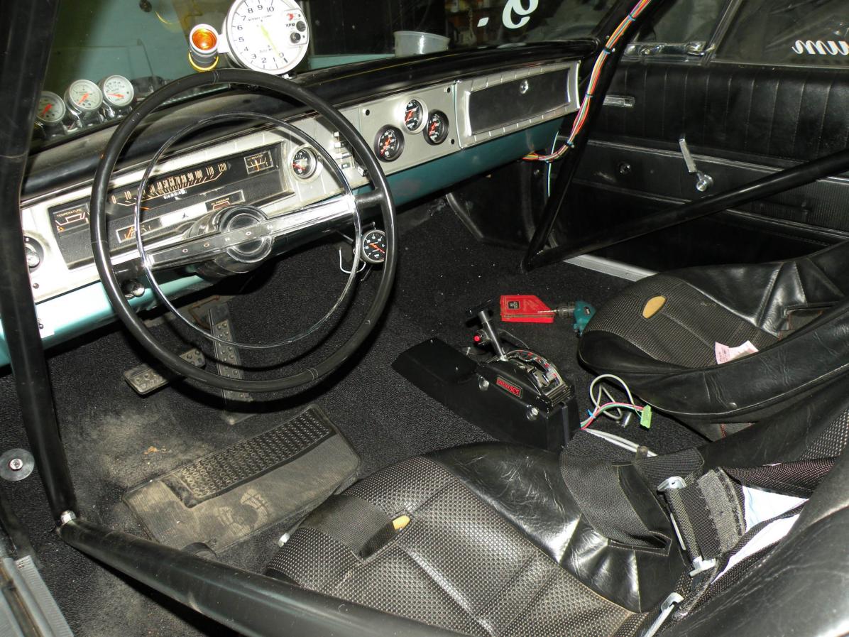

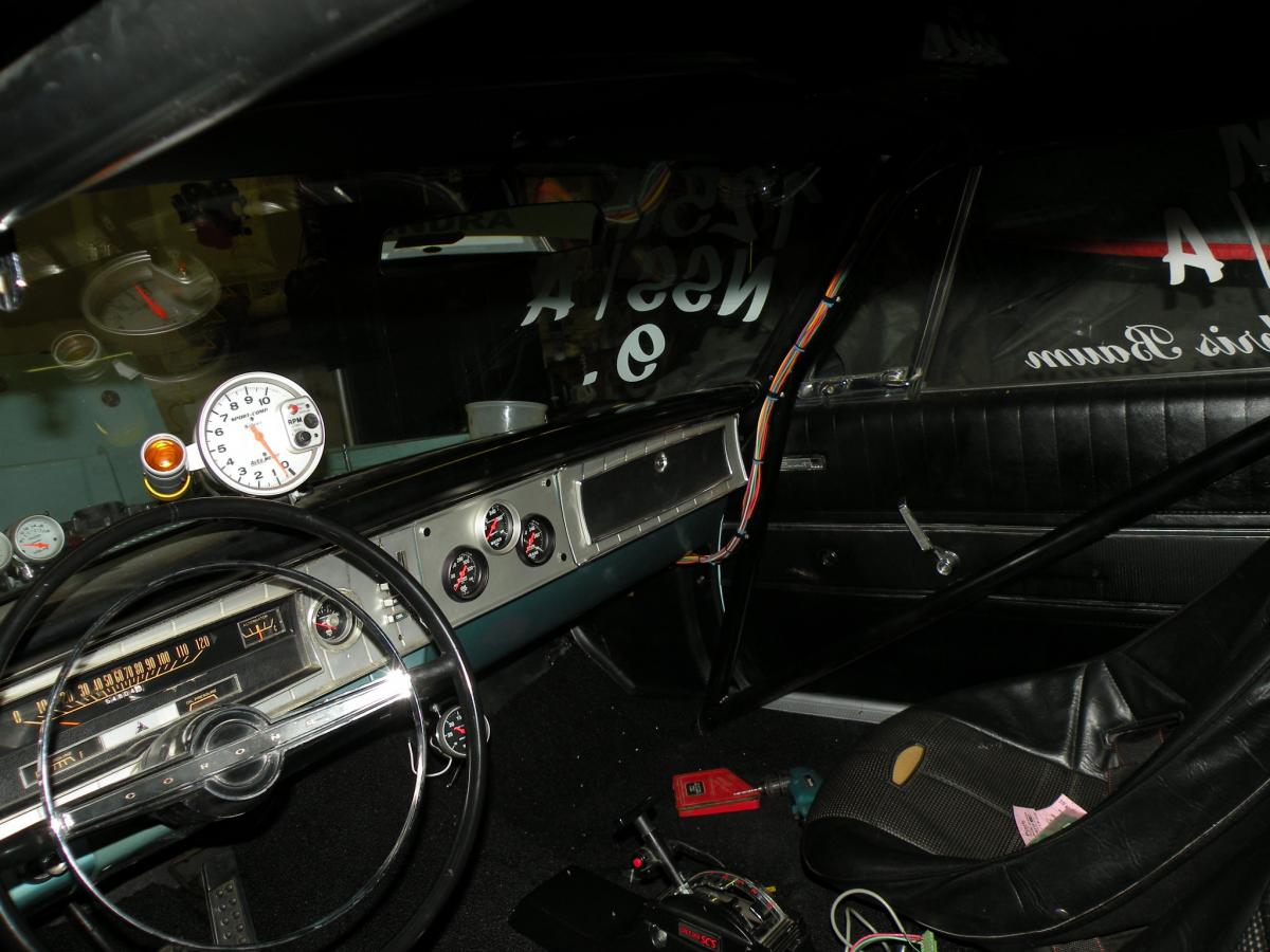

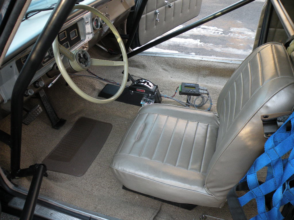

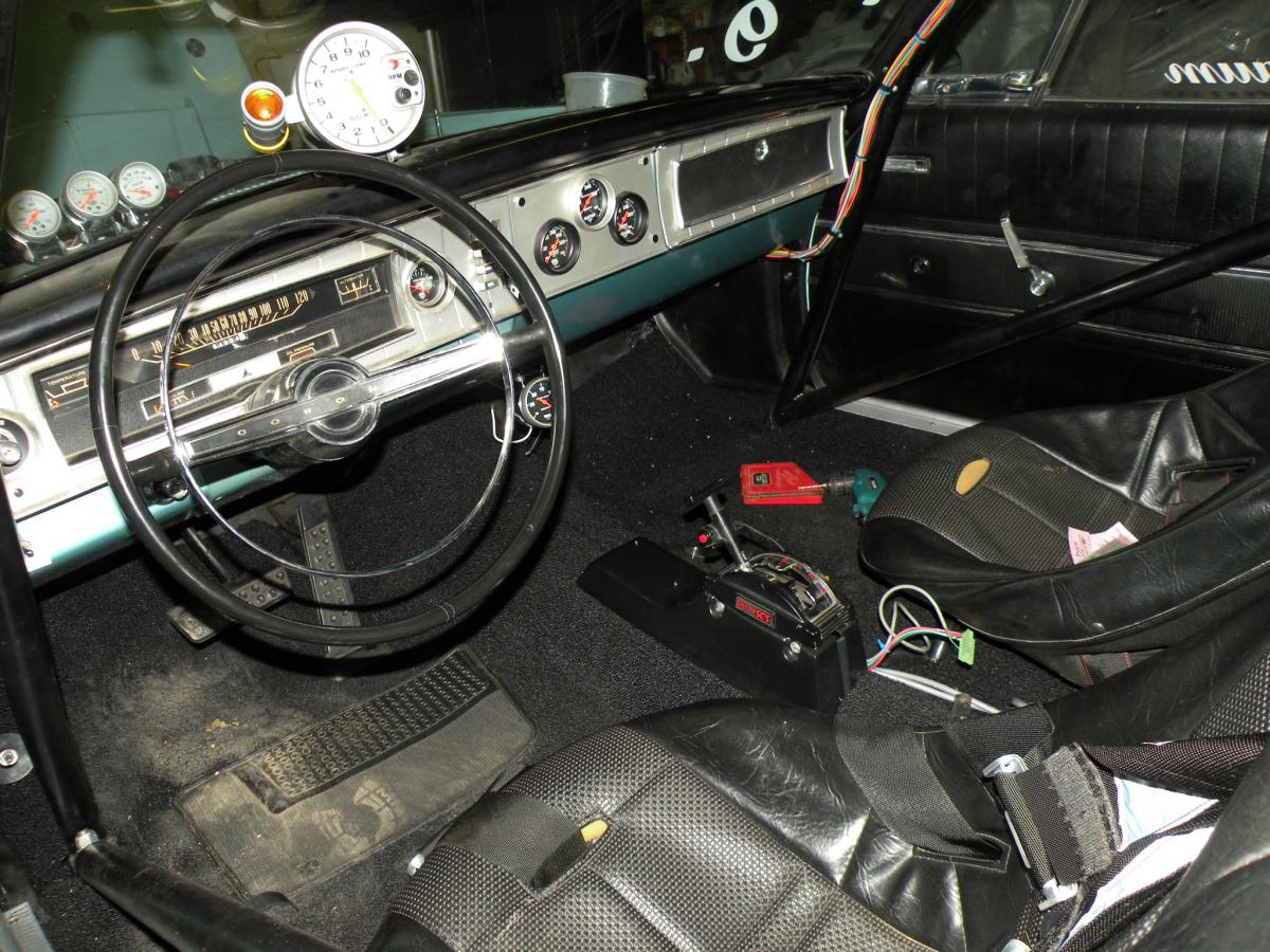

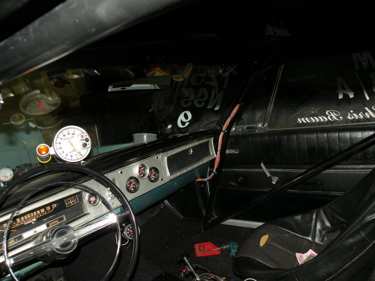

I just put this PPP Shifter with free nuetral. I needed to get this shifter because of my Aluminum rods in the motor. Looks like I might have to get another one for my 65 Light Blue dodge coronet

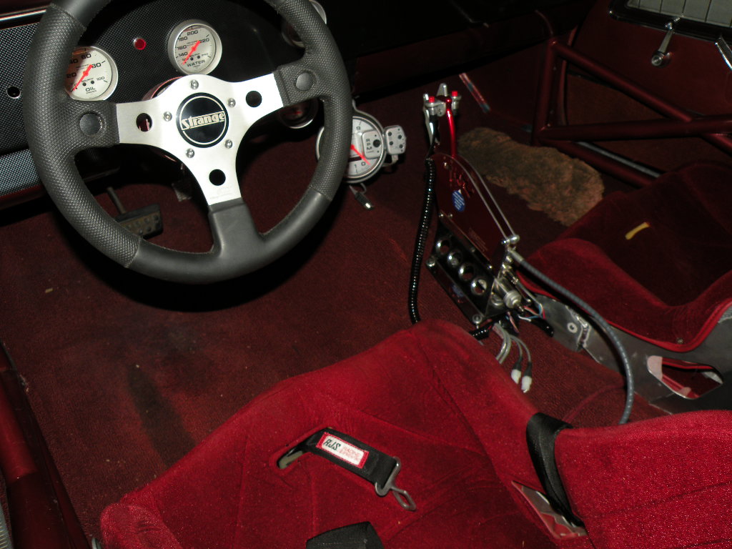

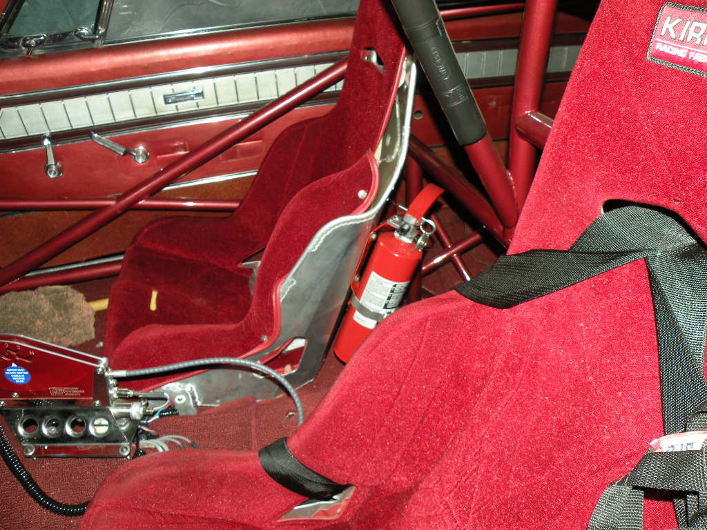

forgot to tell you if you go with the free nuetral you'll need a griner valve body with free nuetral. they make it low band apply or non low band apply.

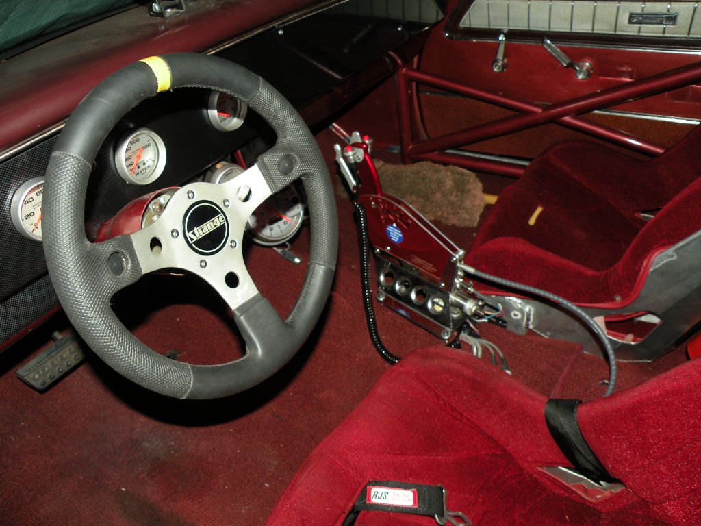

heres a better pic.of the turbo action cheetah shifter scs.
This is a reverse maual shifter and valve body.

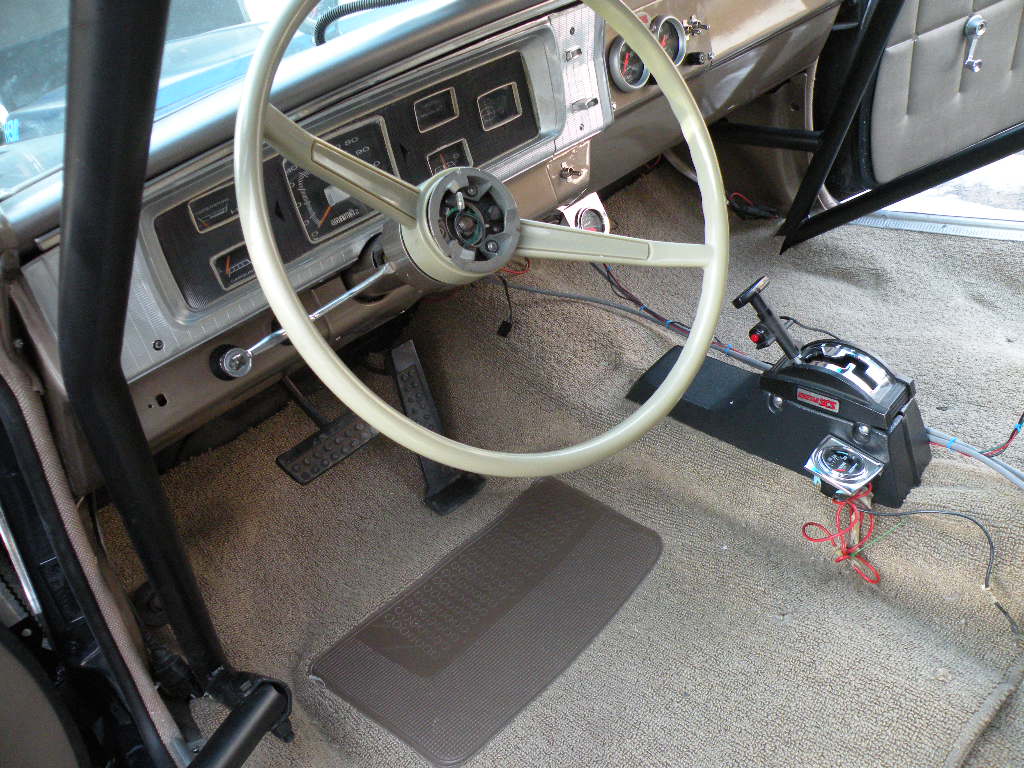

Only thing I don't like about my Cheetah shifter is the stick is not very high - and there is no may to lengthen it. Particular issue if you have a bench seat. I have mine sitting on an aluminum base (it's under the skirt that wraps the base) that raises it about 4-5" from the tunnel and also had my bench notched out so I could move the shifter back towards me more. I would still like it to be a bit higher..
Stumper, I like that setup alot. Very clean.
