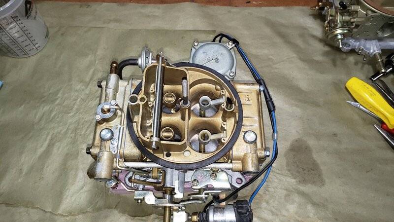

I need a good source to send my 4160 to be restored for my 69 cuda. can anyone refer me to a reliable carb restoration shop?

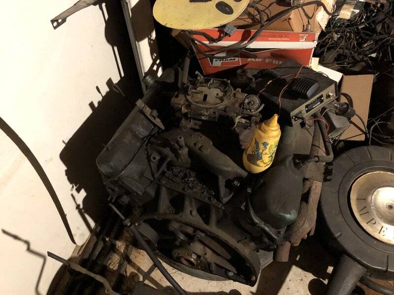

Not all ‘68 New Yorkers. I pulled this one in ‘88, it’s a 375HP TNT. It has the AVS.:D
