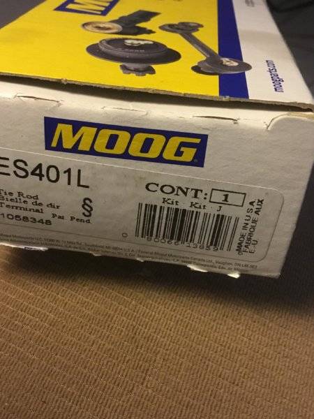

Ahh,
the good old Esatos Unitos. :thumbsup::thumbsup::thumbsup::moparsmiley::usflag:Thx, Wahya!
