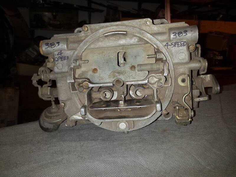

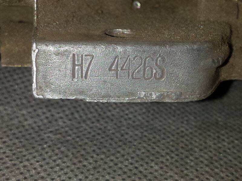

I have this 4426S 1968 383 MT AVS that's not on your list . It could be correct for your car if it was a early built car?

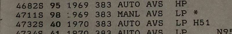

My old 9th edition white book on page 36, shows the
R-4736 is for (1970) 383 4- speed manual trans? And on page 34, the 4711S AVS, is for a 1969 383 Manual Trans. LP & the 4615S, is for a 1969 383 manual Trans.HP. maybe my old book is incorrect ? ? ?

I have this 4426S 1968 383 MT AVS that's not on your list . It could be correct for your car if it was a early built car?View attachment 1237518 View attachment 1237519
IMO.....IF this carb was for a manual transmission application, it would have a pneumatic dash pot and bracket assy on the choke side and actuator lever on the primary throttle shaft. What color is the engine painted? TURQUOISE was low HP engine vs HEMI orange for the high HP engine.

Referring to the pictures of the 4426S carburetor that I posted, it DID have the dashpot and a bracket when I purchased it a long time ago. I robbed the dashpot assembly for my 4617s carb because the dashpot was not being reproduced back then and that's why I'm in possession of this dashpotless carb.

According to my old book if correct? I think you need the 4711S LP=low performance and the * stand for with or without a/c
Thanks much guys, seems to be the 4711S per Tony's post above abd Bob's previous comments. I was unaware the asterisk meant either a/c or non a/c
