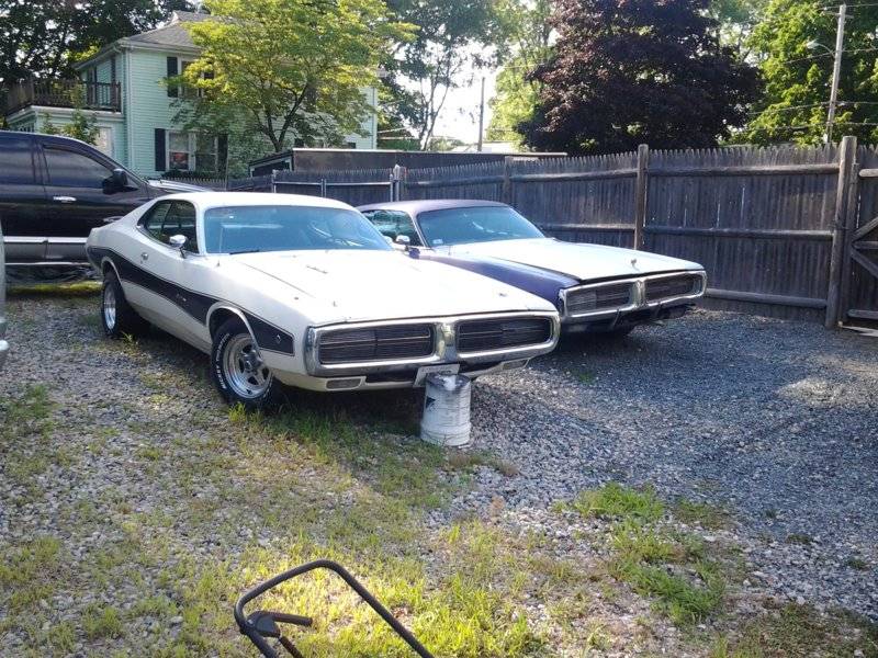

This is the 73 Charger

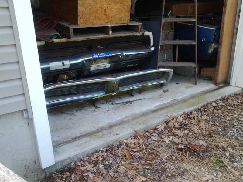

Unfortunately I only have one photo with the 68 Charger in it. It can be seen slightly in the right corner of this photo.
