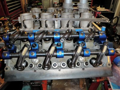

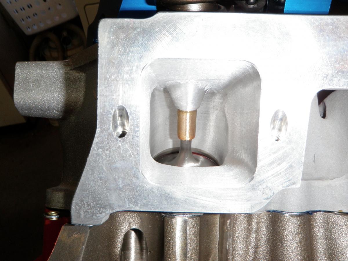

Go with the stage 5, I had mopar pef. heads and had to sell them there was a big step from the port to seat that could not be cleaned up with out over sized int valves, stage 5 rockers are the best ,I have indy with oiling mods ether one you should oil through the push rod on the street and you idle alot.If you are going with a hyd roller cam you will have to elongate the push rod holes about .080 with .610 lift and indy rockers
