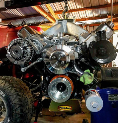

I don't know more than you, and certainly don't know more about fuel injection retrofits. Curious to know though... why are you switching? And whats better about one over the others? Hopefully some folks with both good and bad experiences will indeed chime in. Did you have that stroker runnin on the FITech? It looks like a hummer.
