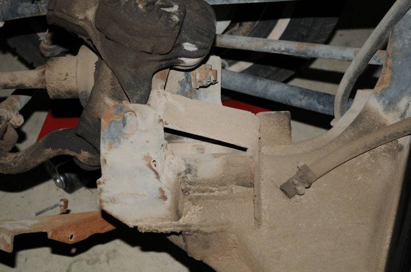

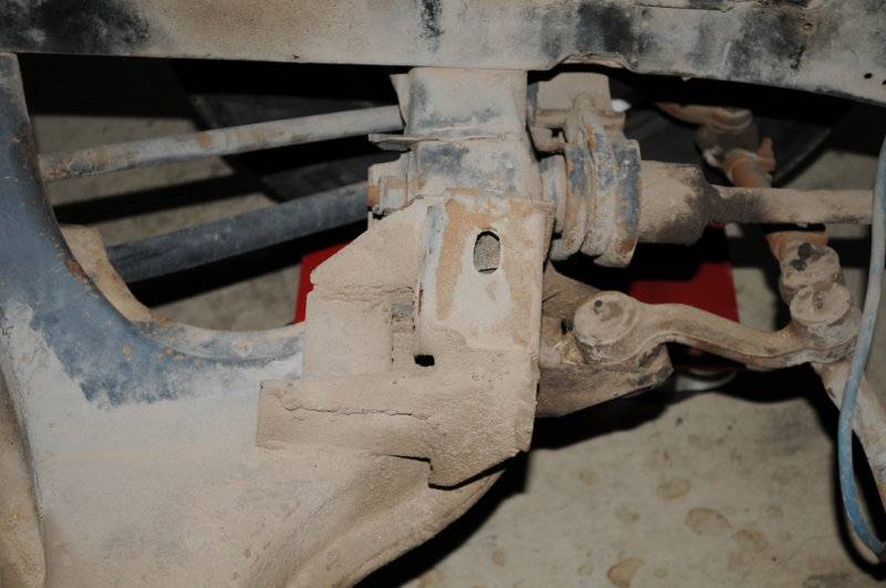

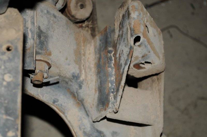

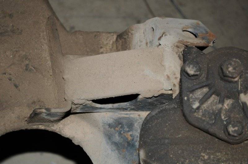

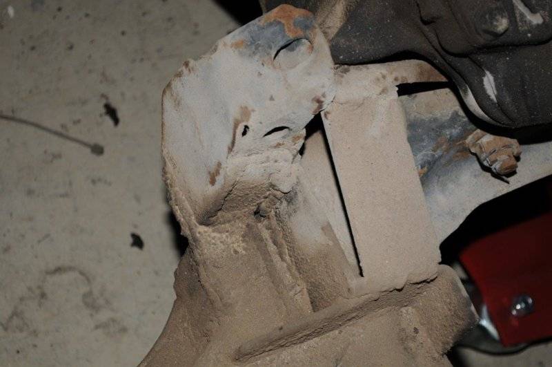

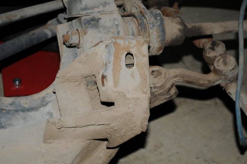

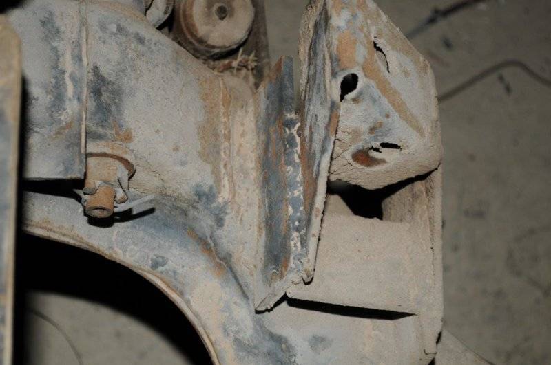

I can't find a match at Schumaker's engine swap website. It's in a 66 Coronet old race car that I'm working on. I ask because this thing is a melange of parts and I don't want to assume it's a 66 or later piece. The link looks like a 64-65 K but the rest does not match. See pics

It's a very early '66 K-member - looks like the perches have been reinforced by somebody.
No telling where it came from. It was originally a six cylinder car. Thanks for the ID though.
snook

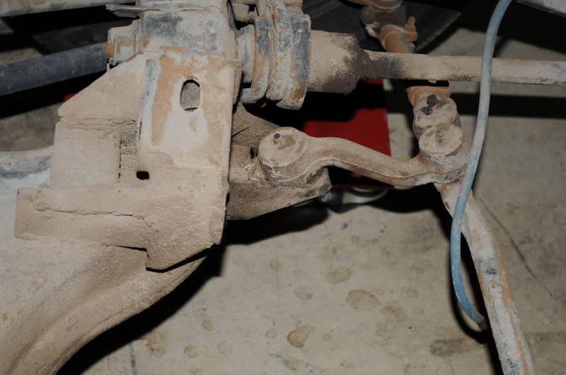

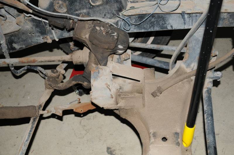

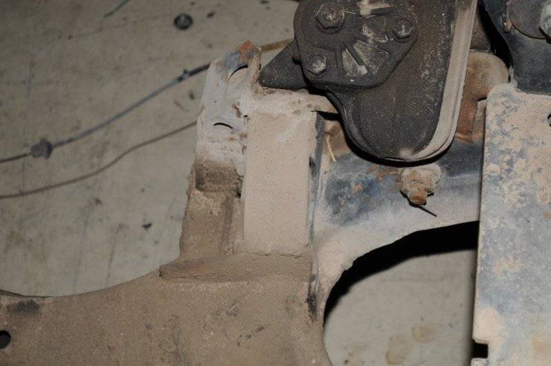

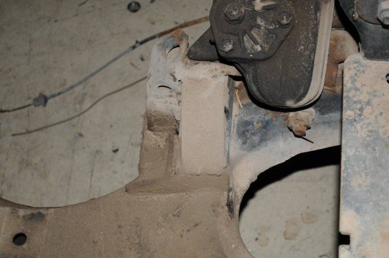

Well it turns out that it's a 6 cylinder K member that has been modified to work with a 8 cylinder. See pics below.
