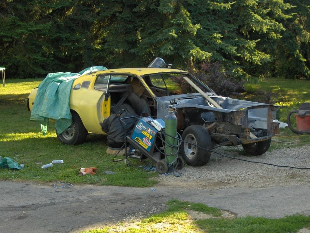

I love my Miller 175,when I got it they were $1200.00-$1500.00can but now you can get a Miller 180 for $900.00-$1200can and for an extra $200.00can you can get a spool gun and weld aluminum.My brother in-law is a welder and can't believe how good of a welder it is.And my friend is a auto body guy and he swears by it.And my mechanic friend can't weld to save his life so he calls me and I use his new Miller 180 I talked him into buying lol.......Around here Miller parts are always in stock but Lincoln parts are always a waiting game. The Miller 175-180 are both 220v 40amp but I think the Miller 140 is a 120v welder and I have heard good things about it as well.
Here is a shot of my Miller 175 in action :)
