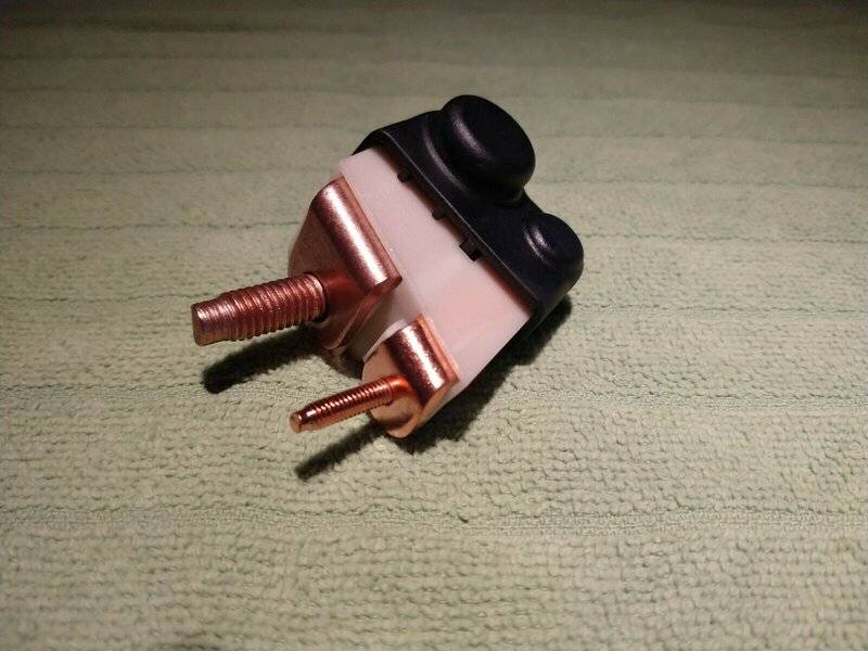

If you go with a mini, you might need this for the terminals
