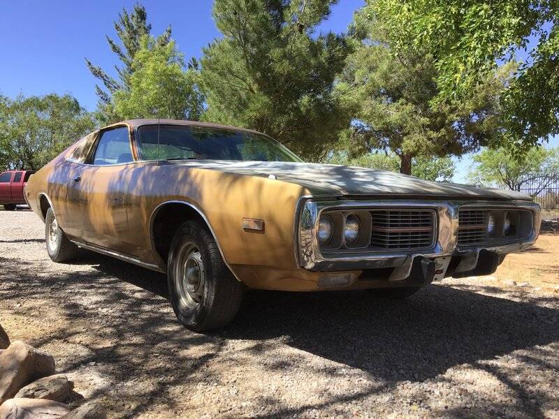

My dad and I are restoring my 1974 Dodge Charger together. We would like the stock appearance but change the wheels to 15”. Any advice on the best fit? Also what is the biggest tire we can fit on the stock 14” rims?

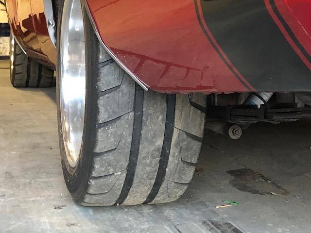

I went with 18" wheels on my red car because I loved the style and wanted low profile tires for handling.
View attachment 1117944 View attachment 1117945

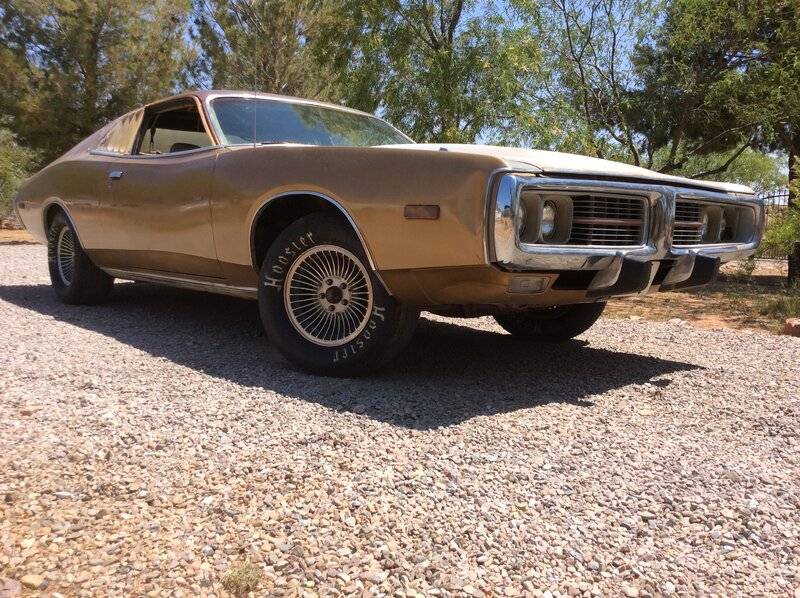

I like the look of the NASCAR race cars where the tires are stuffed in.

Thank you for all the help! We found some rims off a 1980s Ford Grand Marquis. Also, you said you like the NASCAR look. We have Hoosiers off one of our stock cars on there right now.
