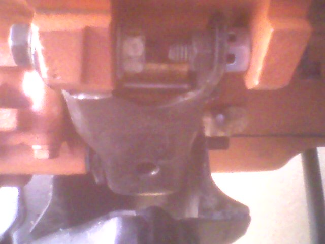

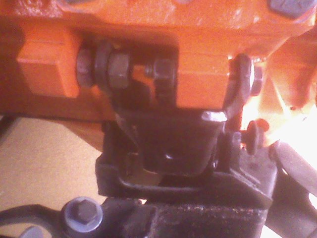

no , they are not the same . the drivers side k member boss is about 1 - 1 1/4" too far forward in a small block K member and needs to be fabricated. in order for me to drop a 440 in a 360 k member , (73 and up) without using conversion mounts , I had to do a little creative cutting and bolt the mounts to the block on the front side of the engine bosses. it equates to about 1" or so . otherwise , the transmission would not bolt up. I discovered this by mounting the tailshaft first , and then working the engine into the mounts. it sits at the right height , and I verified this off of an original big block car. the problem is working around the oil pump.
passenger side mock up, this side was not nearly as far off as the drivers side.
drivers side mock up at bottom. I don't have pics of the finished project, but these mounts are as solid as any now. this was just a mock to get an idea of what needed to be done.
