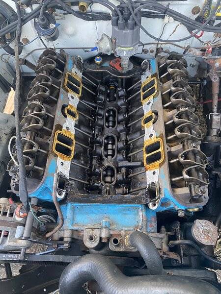

I recently replaced all gaskets, timing chain and water pump on my coronets 318. I also cleaned out the water jacket and replaced all expansion plugs. Prior to doing the work the engine ran/idled great. Now that I put it all together and installed the new ceramic coated hooker headers, the engine is exhausting white smoke from the headers. I have only run the engine for about 5 minute increments for a total of about 6 times. Is this a common occurrence when doing this much work on an engine and should go away after a while? 86F76143-706E-448E-89B8-2EADCB2412D6.jpeg 0E990BEE-0F88-4144-AE86-F0FB6B110D03.jpeg 62AD1965-B47D-4F83-A11E-646EB337AAE5.jpeg

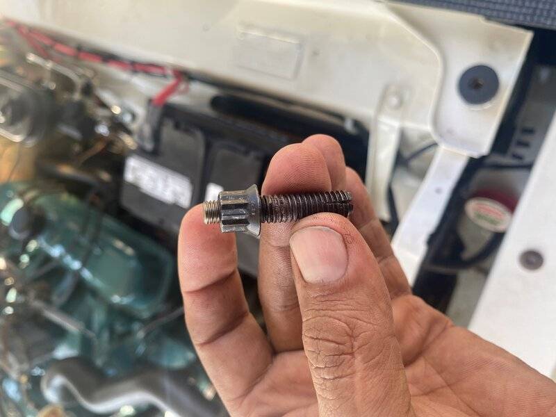

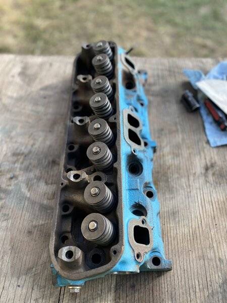

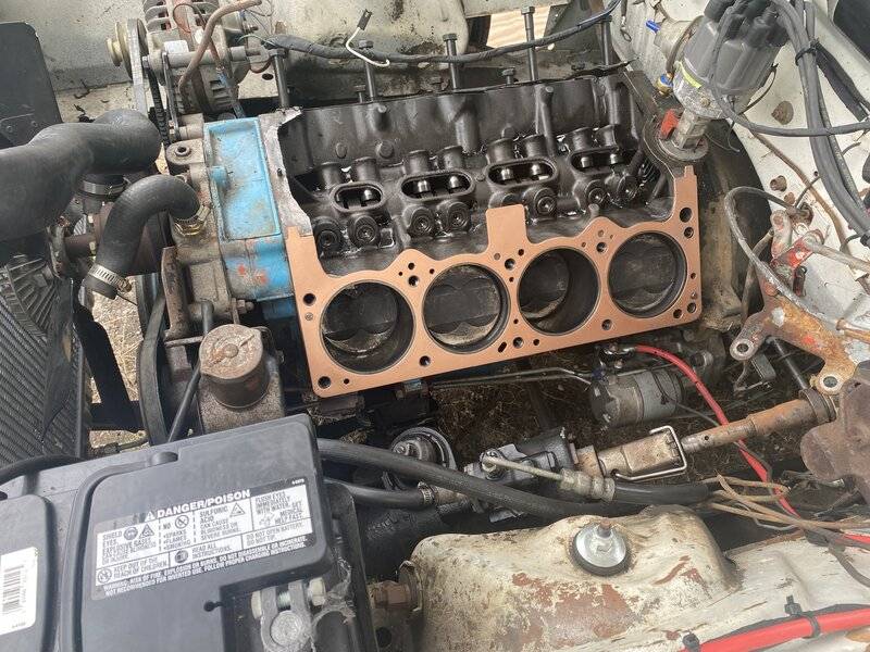

The first thing that jumps out at me is the fact that you sprayed the head gaskets with copper coat which is incorrect; they should go on dry with no added coatings or sealers. You might be leaking water because the new head gaskets can't seal properly. Also, the head pic shows only one exhaust stud. The two end holes go to water, and if the one side was repaired with a heli-coil, it likely is not sealing well and leaking water into the exhaust. Replace a new stud, and try to seal it well, although that can be hard. I will say that a better repait is a Time-Sert in those applications so that water cannot leak past the outside of the repaired hole.
What head gaskets did you use. I hope that was just spray copper coat.

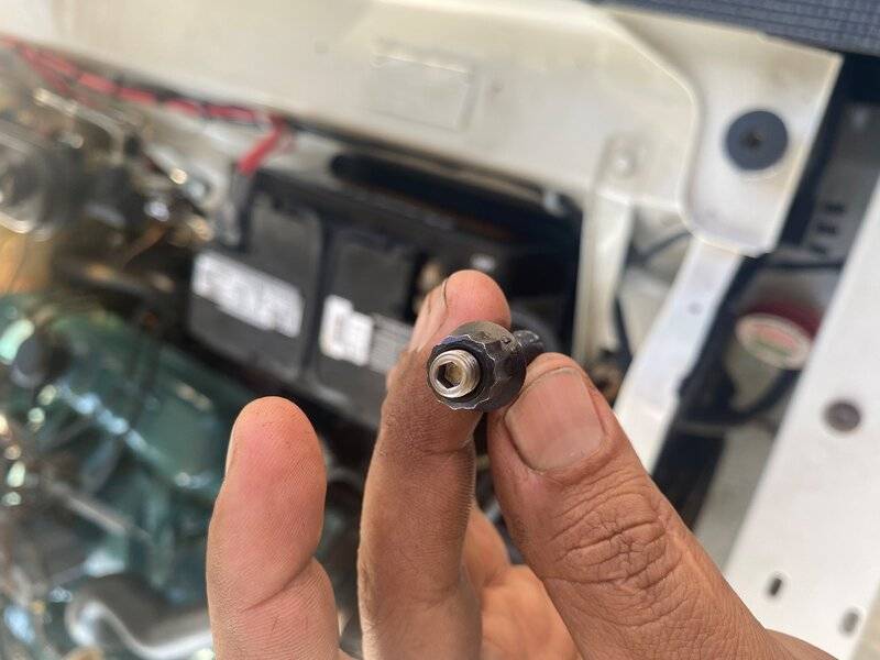

Thanks for the feedback everyone. I used FelPro Perma Torque head gaskets and did spray them with the Permatex copper coating. I actually removed the studs from the heads because I used the split lock bolts from Summit, since the Hooker headers offer very little space when tightening the bolts around the pipe bends. This is how I found out the the first and last bolt on each head actually go into the water jacket. When I first started the engine I had coolant leaking from the rear header bolt on the passenger side. It turned out I had forgotten to tighten the center pin on the summit split lock bolts, which actually prevents them from coming loose and is where the coolant was leaking from. Once this happened I did remove both first and last bolts on each head to add some thread sealer and made sure to torque them down properly.

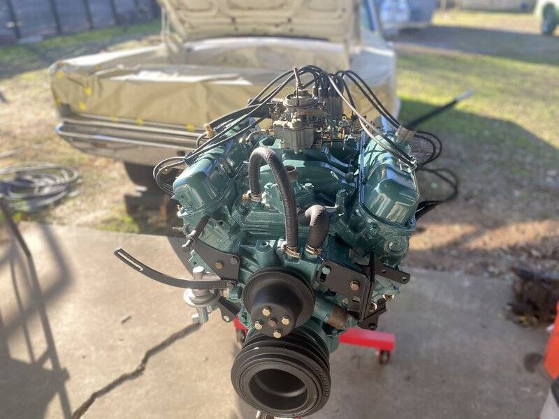

View attachment 1073744 View attachment 1073745
The Fel-Pro head gaskets (Permatorque), already has a teflon coating to allow for proper adhesion and sealing, thus eliminating any head bolt re-torqueing. By applying an additional sealer (copper coat), the head gasket cannot properly seal, and will eventually fail due to gasket movement. The gasket instruction that accompany all Fel-Pro products state to install dry.
Well.... it looks like I may have to do some backtracking to replace the head gaskets and install them with no sealers. Bummer...
