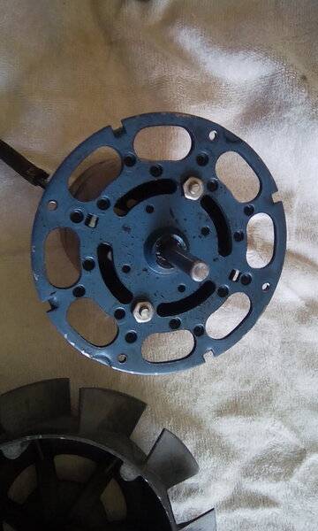

It is mounted on this plate. See the first picture.

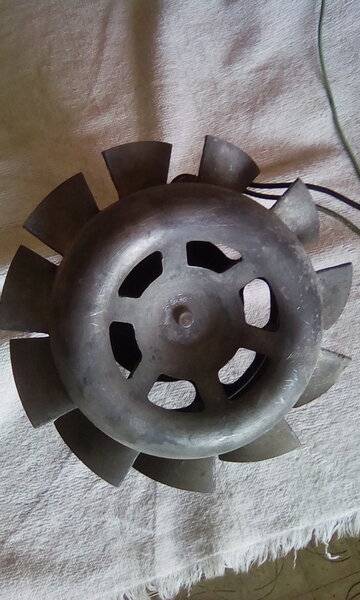

The plate slides over the heater/blower motor's shaft and is attached by two nuts. Then the fan slides down over the plate above that.

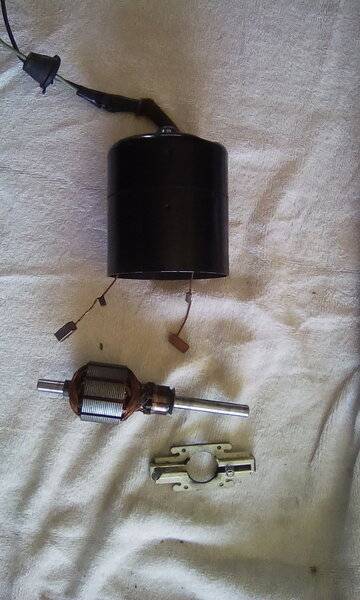

What does not work on it? The brushes look good... You sure it just does not need the insulation on the wires replaced, lubed up and reassembled. There is very little that can go wrong with these... the fuse will blow before you can do much damage to these old DC motors.

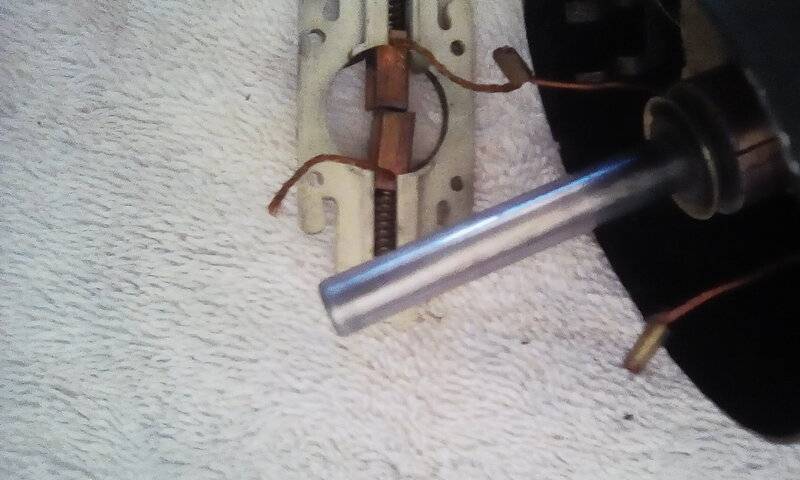

One of the wires that connects one the brushes is broken. But I laid them together before taking the photo. I tested the motor before disassembly and it did not work. Not being an electrician, nor having any experience with electrical motors, I was thinking of having some else repair it. The wire insulation looks good and that is something that I can check further. The bearings seem to be fine. There is a lot that I can do, but this isn't something that I have knowledge of. Tho to be honest, I would really like to learn.
broken at the brush? Better photo of it?
Okay, will do. Give me a minute.
I hope that these photos help.
Do you have a Service Manual?? All though the manual doesn't show heater motors, study about starters. They are basically the same thing as a motor. If you took this apart, you can put it back together.
Clearly that wire needs fixing, it looks attached in post #1. Take some fine sandpaper and run it over the armature and the small copper area. those 2 Brushes ride the commutator to spin the whole thing.
I guess you didn't play with slot cars as a kid???:poke: Good Luck
