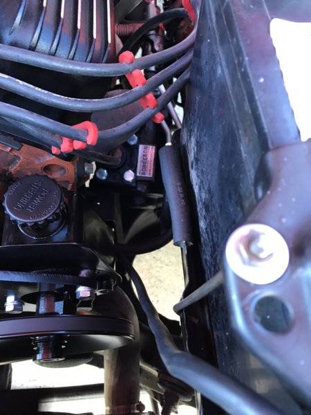

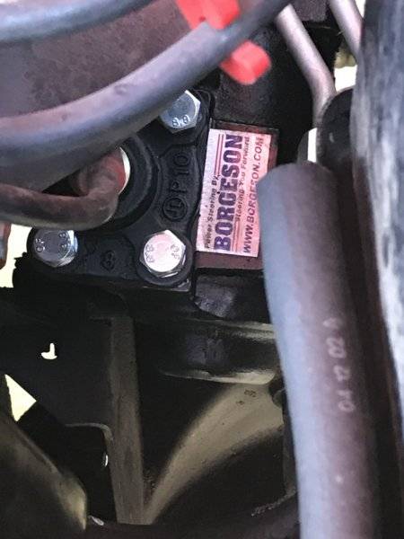

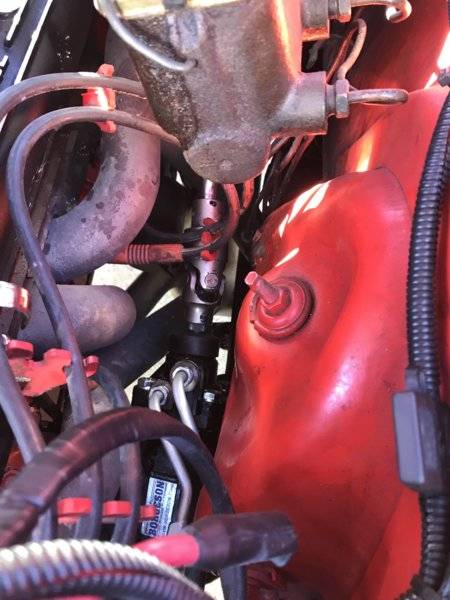

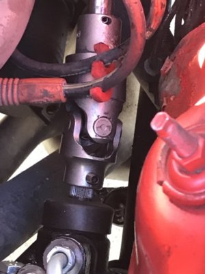

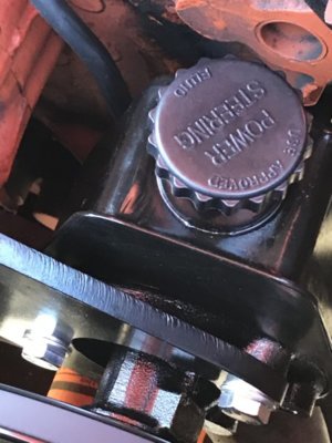

Just a note when installing.. Leave the steering gear loose. Do not tighten it down until you get your steering shaft in place. Its kind of a pain in the *** if you have it tight before. Here are some pictures for you of the install I did.

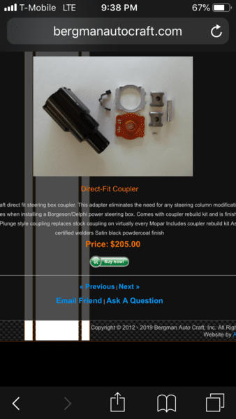

Don’t cut the shaft. Buy the kit from Bergman that includes the custom designed coupling to fit this that looks from the outside like our stock couplers. I think Rick Ehrenberg from mopar action helped design the coupling from what I’ve read.
i cut mine didn't hurt a bit.
The point is...cutting the shaft makes for a permanent change. The hybrid coupler allows the owner to revert back to stock if ever the need arises.
