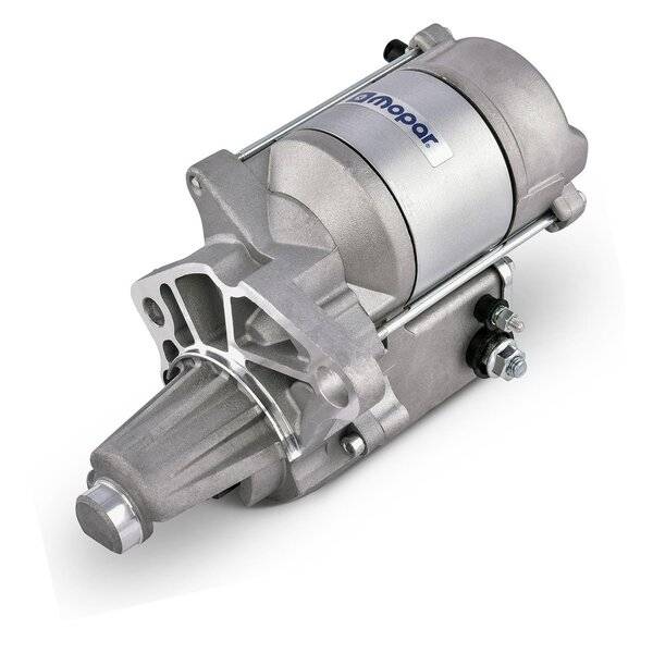

Summit racing, Proform:
https://www.summitracing.com/parts/pro-440-415

I haven’t tried that starter. But I could recommend a mini starter by Delco from rock auto , fitment for late 80’s early 90’s Dakota v-8. Works great on my 10.5:1 compression 451. Price is way less than the summit mopar one by proform. I think proform quality is hit or miss.

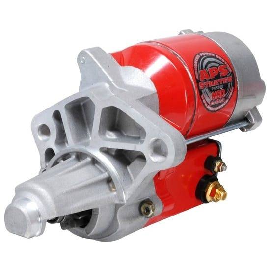

After looking at a number of options, I got a MSD branded mini starter. Works great, I could care less who actually makes it, and I like the red paint...
Oh, and did I mention it works great?
Looks just like the one you are asking about. (Except it doesn't have the awesome red paint lol :carrot:)
