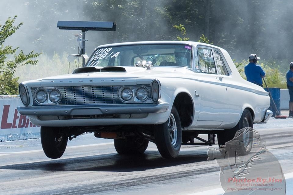

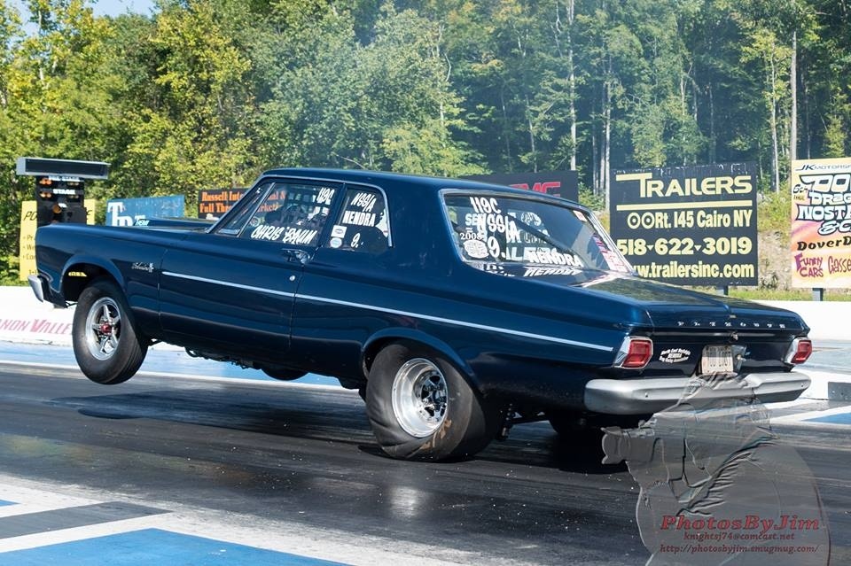

I love my 2.74 low gar set from A & A Transmission
