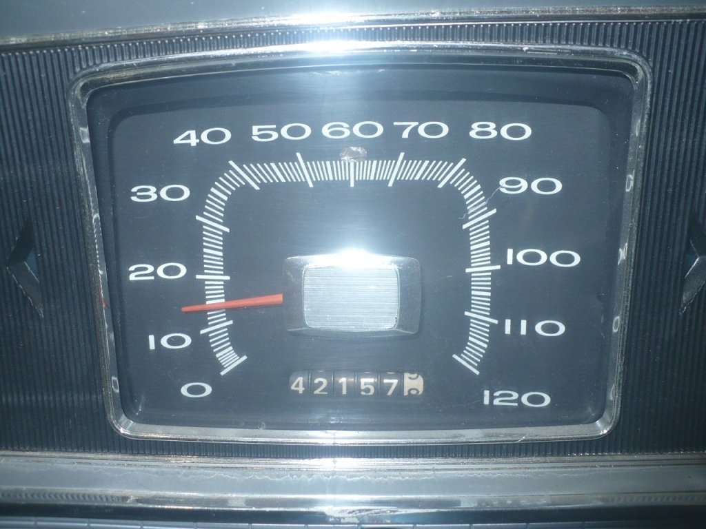

Thought I'd hook up the speedometer in the 65' Belvedere. I haven't used it since changing to a manual trans, just ran by the tach. Does anyone know why at static it reads 15mph? Is there an adjustment inside? Or is it toast? Too wet to get the car out for a test drive. But on the lift it works fine. No jumping or noise. Just doesn't return to zero.

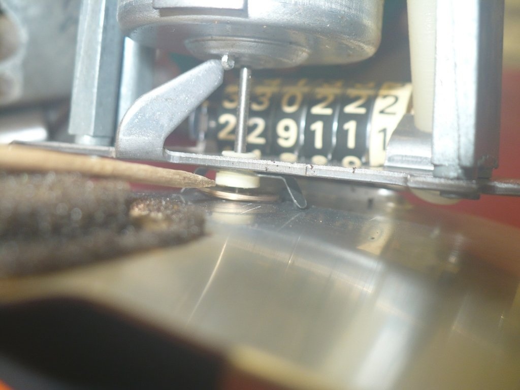

Update! I pulled the speedo head and found that a small spiral spring had moved. After adjusting the spring to zero, the speedometer works great. It's a spring with a tension tab that keeps the needle at zero. Didn't have to move it .060" to obtain the correct reading. The tab/spring is at the end of the tooth pick in the pic. I guess I pegged the needle past the 120 mph one too many times. I'll disconnect the cable before I run it again. Hope this helps others.
