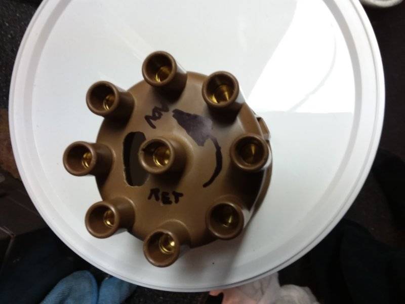

Thought I had my car running well but the more I pushed rpm I found it would break up at 5200+. Started checking everything and found rotor phasing way off.

I couldn't get a photo while running but set it up in the following photo as how it looked. I decided to take a look after it appeared to be firing off the trailing edge of the rotor.

Rotor phasing is better but still not perfect (still firing past the cap terminal) So seems like rotor would need to move clockwise in relation to the trigger. (or trigger moved counterclockwise in relation to rotor, same result either way I guess)
