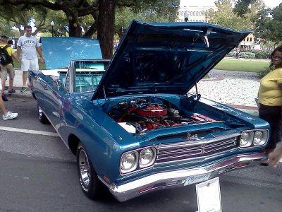

You know, I had heard a lot of negative comments and reviews about PUI, but I just learned one of my friends put PUI in his 69 Sat vert. I saw them for the first time at the Lake Mirror show Saturday.
They look pretty good. Not the best shot here, though-

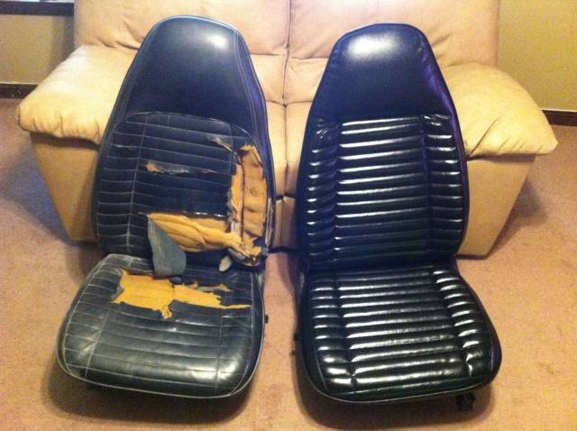

Yeah, Year One's seat covers are for sure PUI. I ordered a bunch of stuff from them when they had one of their 30% off sales and seat covers were one of the items I ordered. I had read around before ordering and everything I found said that Year One was still sending out Legendary... That was before I joined this site and apparently those posts were old. The ones I received are PUI. I installed the covers this last week and they look pretty good but as described already, but they aren't perfect. Then again, I am nothing if not an amateur at installing upholstery (I've done 4 sets now). I just went ahead and used them since I had them and didn't want to wait for who knows how long to get Legendary's. I really think they look pretty good and fit about as good as they could, considering... I think they ran me about $280.
These are for my 72 Satellite Sebring Plus / RR cloner. This was taken right after I had "finished" the first seat just to show a friend. I have since been able to work some more of the wrinkled areas out. They really look pretty decent in person and were a snap to install. I'm sure you guys doing restos on big money cars will prefer to go the Legendary route.
Hope this helps.
