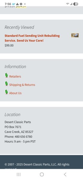

there is a guy right near you. Desert Classic parts. Ask for Bill
