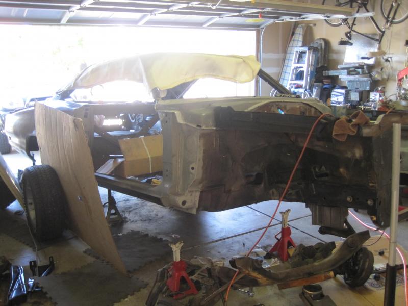

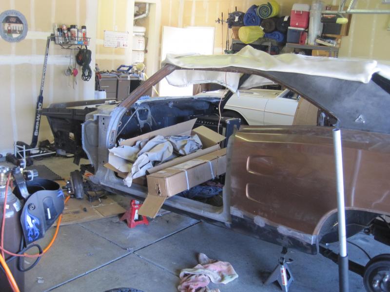

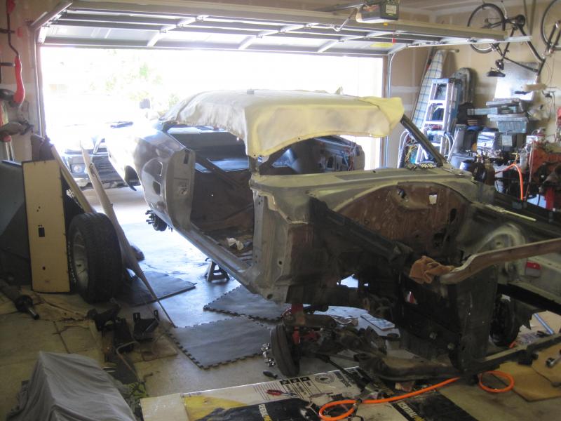

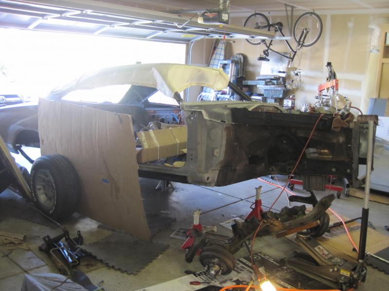

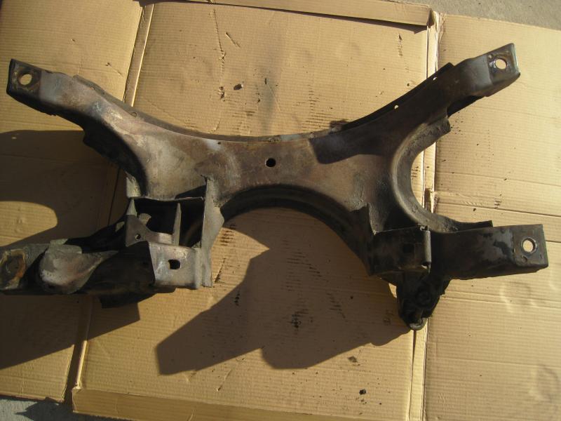

So, I got the front end with K member out this morning. Only took about an hour. Three of the 4 K bolts came right out; the LH side rear bolt which is right over the spindle that took the impact when the wheel feel off, took max effort. I had to use a breaker bar because the impact wrench wouldn't budge it. I'll be getting 4 new bolts.
For all your first timers like me, read on: if the engine is out of the car when pulling the front end, and the rear end is still in, all the weight is now at the back of the car and that's not good. How do I know? Cause when the last K bolt dropped the front of the car rebounded up like one of those see-saws at the park and started rotating off the rear jacks. Scared the **** out of me - literally. After the car was secured I went in the house and dropped a deuce which lightened me up about 10 lbs.
Fortunately the rear wheels which were loose from the car but tucked into the rear wheel well, prevented the car from rotating off the rear floor jacks. Otherwise the car would have either tipped over on it's side or come crashing down on the rear frame rails. My son was at his friends house and my wife was on her 5 mile walk. So I'm leaning down on the radiator support keeping the car steady trying to come up with a plan. How's this for ironic timing - I'm standing there for about 5 minutes when up pulls the Fed Ex truck and the driver comes into my garage with my PST front end parts. He says 'Hi', I say 'Hi', he asks where would I like the box?, and I said to just leave it there on the garage floor. He says 'Bye', I said 'Bye', and off he goes and I never moved a muscle. I'm not making this up.
So I'm standing there for about 15 minutes until Maria walks up. She's a trooper and has helped me numerous times before on this resto when I needed a hand, so she held down the front end while I jacked up the rear as far as the floor jacks would extend and then dumped my son's old guitar amp, which weighs about 60 lbs, into the front of the interior along with the battery and another 40 - 50 lbs of parts.
Morale of the story - always keep in mind the principle of gravity when working on your cars.

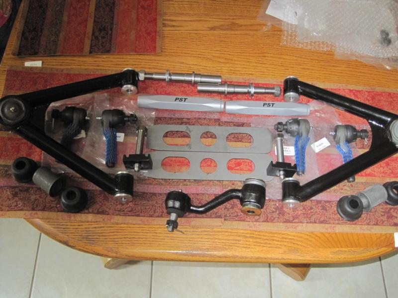

And on a positive finish, I got my parts: tubular UCA's, 11/16" tie rod ends and solid adjuster, LCA rebuild kit, idler arm, strut rod bushings.

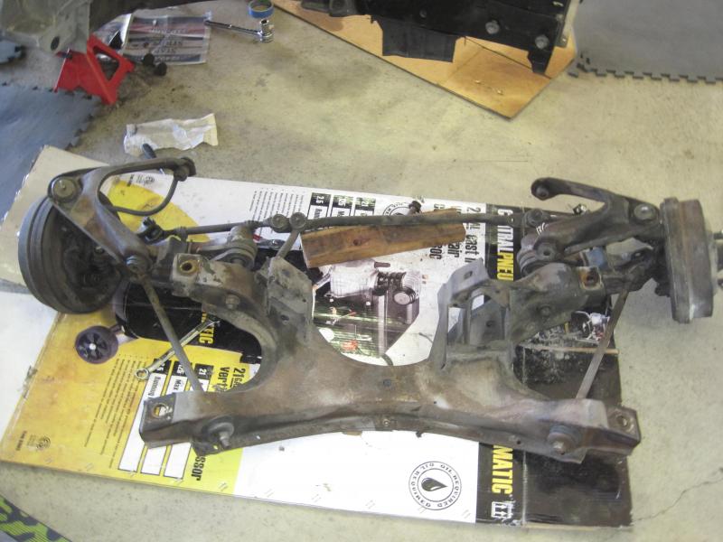

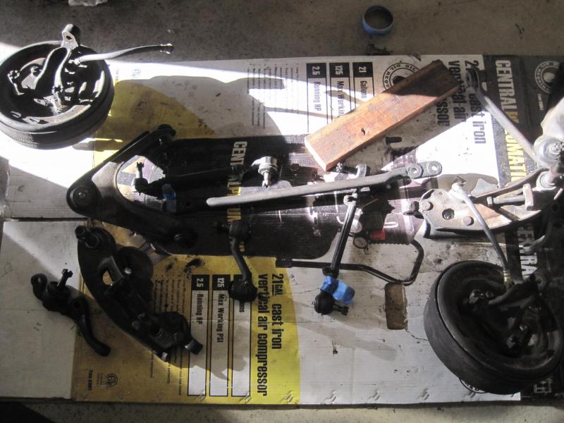

Well, the front end is disassembled. It took about five hours but it wasn't very hard. The most time consuming part is getting those damn cotter pins out. It's kind of a shame because the PO had changed out all the ball joints and tie rods about 10 years ago, but only put about 2,000 miles on them so they look almost brand new. I can reuse the RH lower ball joint, the LH lower ball joint's rubber seal was shredded during the accident. The K frame and LCA's will be sandblasted before reassembly.
