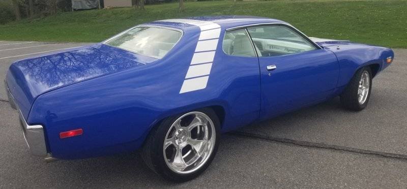

I'm running 295/40/ZR 20's in the rear without issue. The 18's up front however, different story as they will rub if I cut it too hard. Not sure about the BS'ing. Just reached out to the previous owner to ask...
