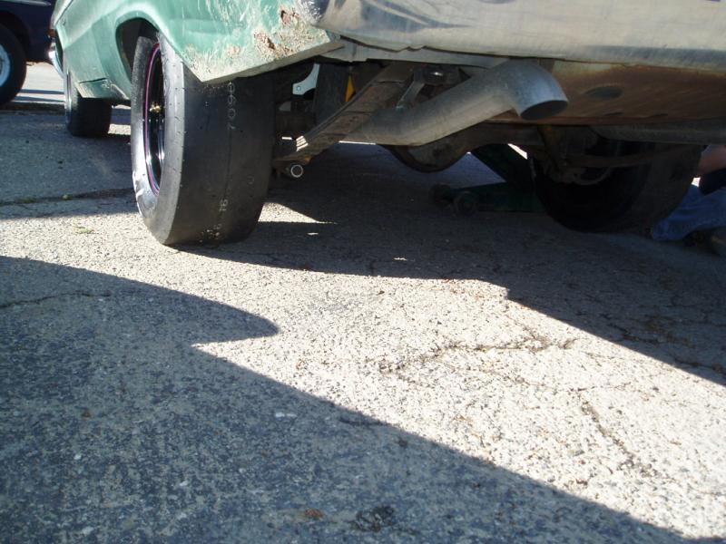

I'm running a 3" TTI in my 66 Belvedere and it fits fine. Go for it!
Thanks Meep-Meep, wondering if you were going to chime in. So are your springs moved inward or in stock placement?
Totally stock.
AHHH there it is. Looks like your springs are in stock placement. Also looks like the pipes are tight going between the springs and the gas tank.
stock...3 inch will squeeze in....if you move the springs...nope
Yeah, they are tight, but nothing hits.

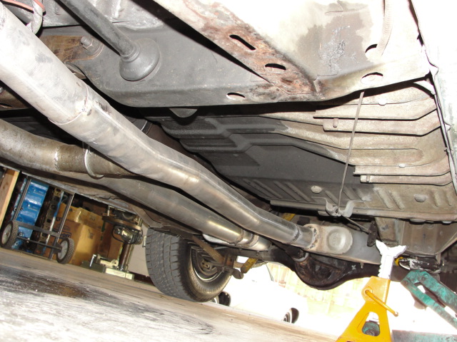

Full 3" exh on my 63 with the tail pipes all the way to the rear bumber. Its all stock in the back as it has stock wheelwells and the springs are in the stock location. In this setup the 3" tailpipes fit on my 63 with room to spare (but not alot of room to spare).

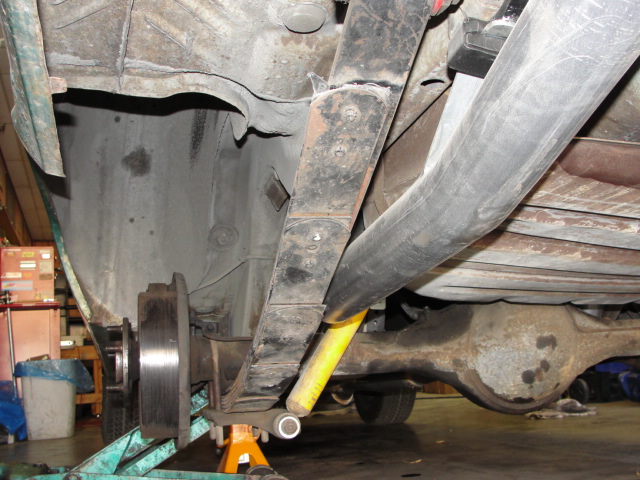

I mini tubbed and moved springs on my 66 coronet. Springs hit the tank and the filler neck wouldn't fit without fabricating a new one. Had to go fuel cell.
With the springs moved 3 inh in its just about impossible to install tail pipes .i had to move my springs back out to stock to put tail pipes on but its worth it to me to be able to hear the radio or a passenger talk. Also had problem with springs rubing the tank and making a rubing sound continously on my 67 satellite
