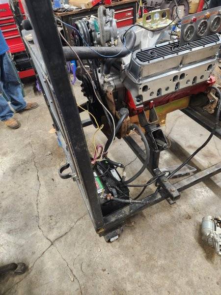

I have a 66 belvedere 2, 408 small block stroker with brodix b1 heads, borgeson small box power steering, manual disc brakes, cable shift 727. W2 headers will fit the brodix D shaped exhaust ports. Only headers I have found are are Hedman 75130 with 2" primaries. Going to run 3" exhaust. Will the 68-73 A body headers work in a 66 B Body?

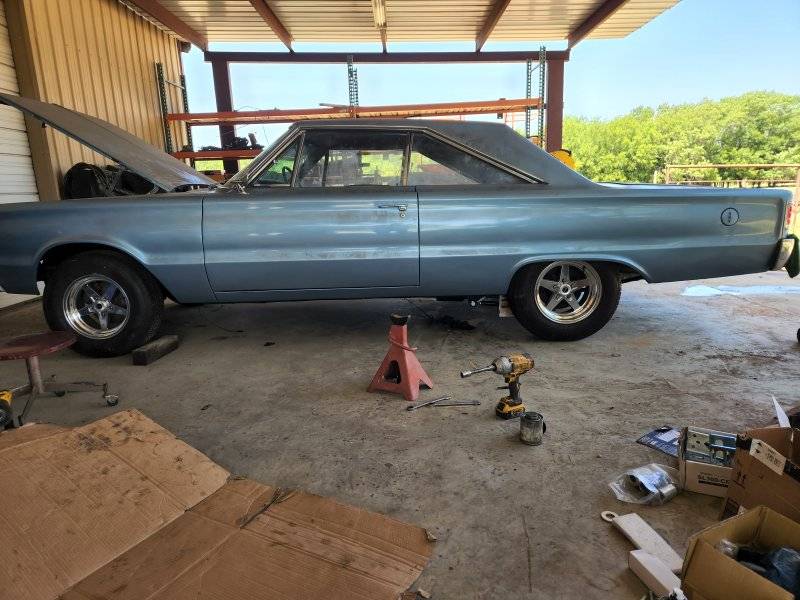

As Kern said,If you look at generic Headers from Jegs or Summit and several brand names they list small block fits A+B.
Nice 67 ? I'm guessing. Looking good !!

Thank you, it is a 66. To dig a little deeper, tti make a set for edelbrock Victor 6170 heads that have a raised port and face, just like the brodix b1a heads, but tti says they do not fit the brodix. Hmm, I guess order them and see if they work, if not then return them. A custom set of 304 stainless headers local to me start at $3750. I Google my heart out and didn't see anything about it. Just that the Victor heads use a w5 exhaust flange which is close to the brodix that takes the w2 flange.
