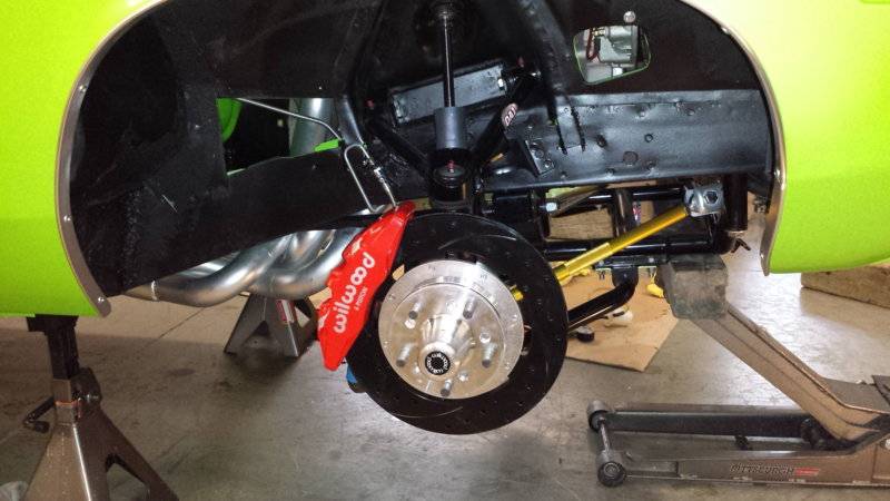

Are these the ones that fit the Mopar drum brake spindle? If so then you can rear mount them. Front mount they will probably hit the swaybar.
These are on drum brake spindles.

Sounds like you have never installed Wilwoods. Don't need a big tool box and yes, they are pretty much a bolt on job. Pretty easy really.
