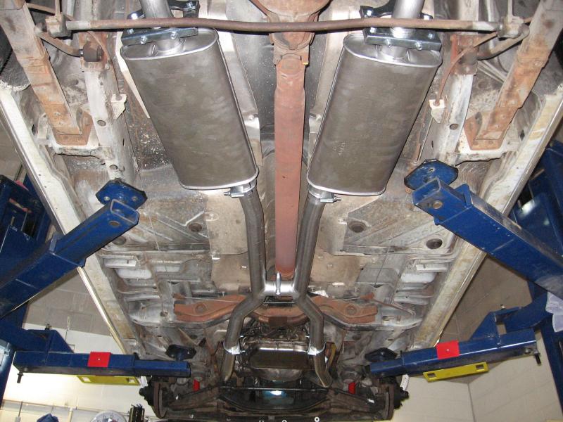

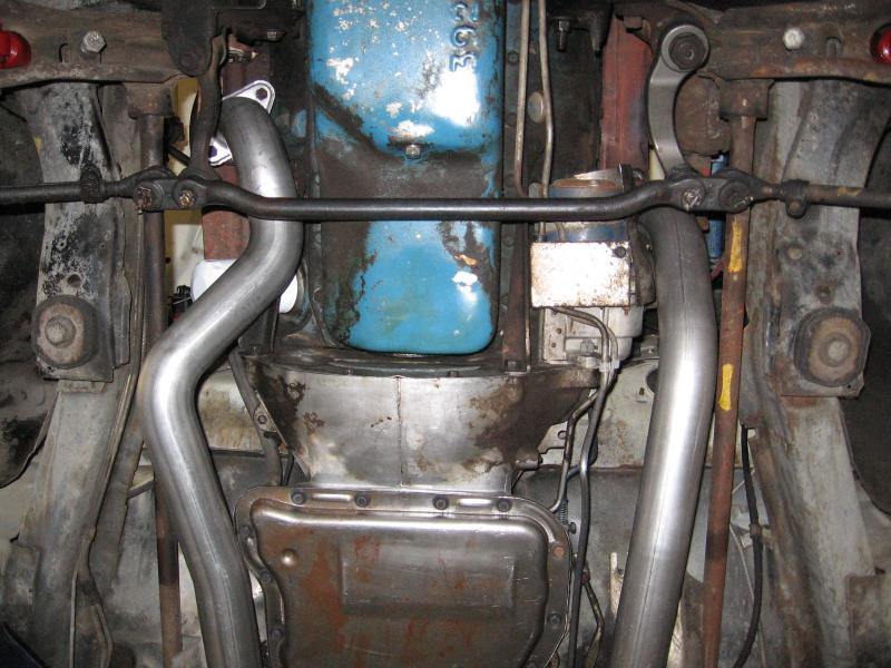

I got mine from TTI.79 Cordoba 300. Fit perfect and sounds great. 2 1/2'' from front to back.Photo of pipe near starter looks close but has plenty of clearance.
The kick out of the passanger pipe is for oil filter removal and also has plenty of room.Comes complete with brackets and hangers and all clanps. Roughly $600 shipped to your door.
Forgot to say that TTI's web site shows the listing for the 75 - 79 B Body.
Yes you can also get them in 3'' and for headers.

Wow! Looks awsome! The local shop quoted me a similar price. When I visited the site and see I have a few decisions to make. I am torn between doing it my self, because I've done so much of it, or taking it in.Thanx for the diredtion.
