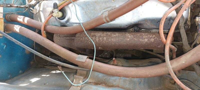

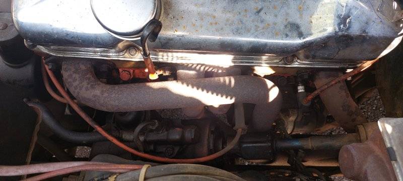

440 with some very radical sounding parts inside... (I know nothing about this engine, just what it sounds like...) Holley 850 double pump, high intake and craaaazy idle sound. Very deep and ballsy.
Can I damage the engine by not having "headers" on both sides? The passenger side looks like a stock manifold but appears to be solid with no holes. Can I put a new header on the driver side only? Here's some pics. Thanks.

Ideally, the exhaust type should be equal left to right, but running it like that temporarily or without exhaust piping is not going to hurt anything but your ears and relationships with your neighbors.

Cheap headers for peace of mind. Or source a driver side exhaust manifold. They should come with gaskets, bolts and collector pipes.
To answer the question, you won't hurt the engine. However, the side with the header may run require slight enrichment for best results, which will be hard to do on just the one side with an open plenum.
That looks like a high performance factory manifold on the pass. side. May want to consider finding one for the driver's side. I wish I had gone that route due to hot interior temps. Headers will be cheaper I expect.
