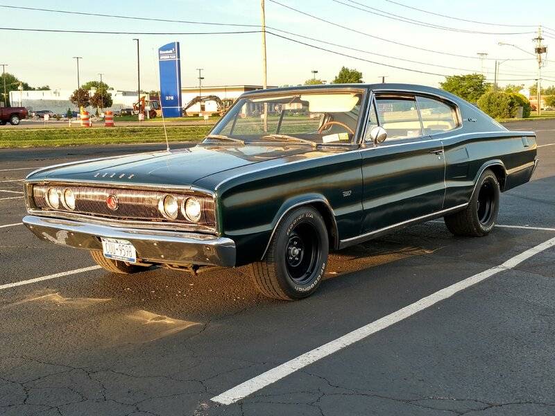

I have 15x8 with 215-65-15 on the frront
15x10 with 295-50-15 on the back
I had 245-60-15 on the 8" rims on the front but they would catch on the wheel lip moulding.
The 215's had to be stretch a bit to seal up on the rim.
If you like alot of sidewall then the 275-60's will be good for you.

235 70 on the front of mine,, if your wheel alignment is whack, may rub.
275 60s fit on the back.
Not sure on the bs numbers.
215-70-15 on 15x7 steel rims up front on mine and 275-60-15 on 15x8 on the rear, plenty of room everywhere
