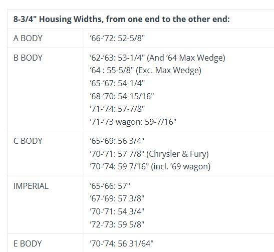

G Day All, A quick question on fitting a sure grip 8 3/4" with springs from a 1970 Challenger into a 1965 dodge Coronet 440. Would like to use leaf springs if possible. Thanks for your time and Knowledge. RC
Short answer no. The 8 3/4 chunk will work, but locate a 65-67 housing and axles for that chunk. You can move the spring perches on the E body housing, but then you will be limited on stock rims sizes.
Housing width is wider by several inches (3") and probably perches.

It is 2" wider (1"each side) than a 69 Charger, perches probably need moving.
Well that just sux. Please correct me if i'm wrong but i'm thinking i would have to move the perches and have a bigger backspace to make it work or sale/trade for a shorter 8 3/4? Thanks for the timely response. I'm new to the forum and it is greatly appreciated!
