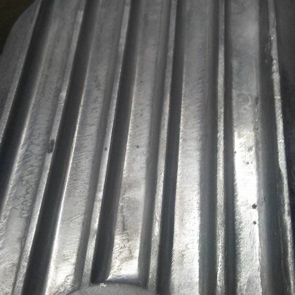

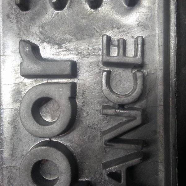

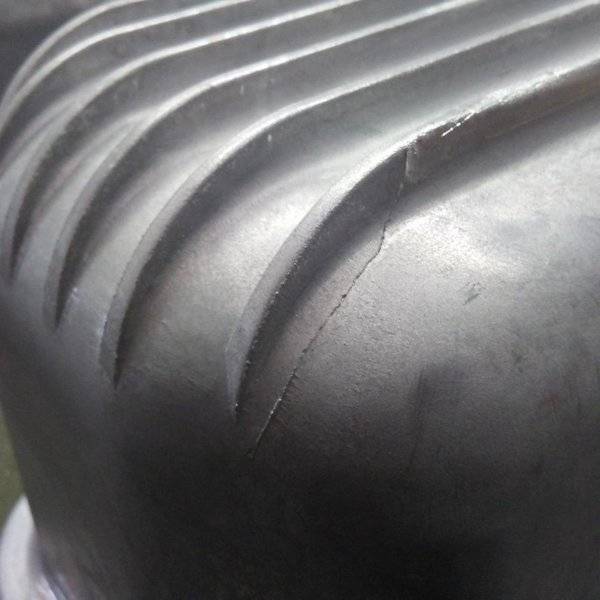

If yours is also a show car though, you might be curious to know how they really look. Out of the three versions available (as cast / natural, polished and black wrinkle finish), I personally believe they pick out the absolute worst castings for the black wrinkle variety and then apply a **** ton of paint to cover up all the castings defects. This is what they really look like underneath ... and the "Made in California" ones are even worse.
The first valley under the knock out on the right hand side is often so rough it can actually cut you open. This example is mild compared to most.

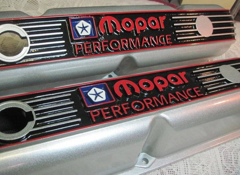

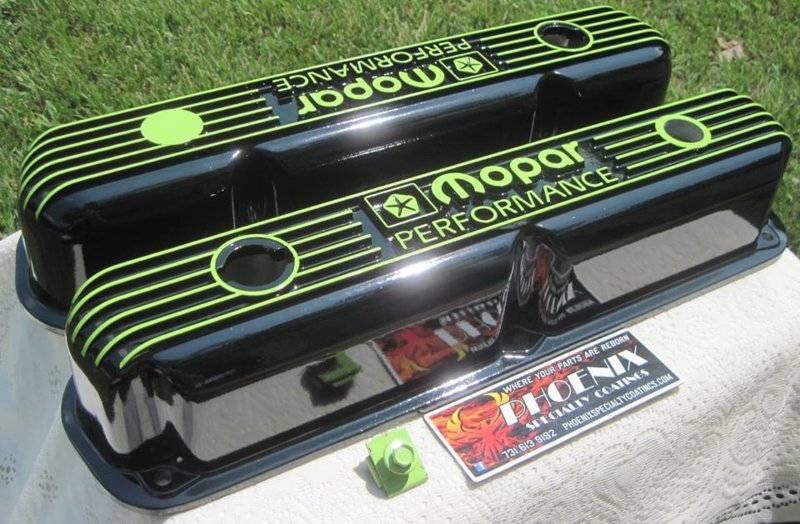

They're a lot of work but they can turn out really sweet.
