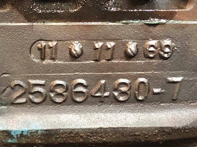

I parted out a 1971 Chrysler 300 several years ago but never looked at the engine that close. I just thought it was the original engine to the car.
Turns out, it wasn't.
This one is dated November 11 1969.
I need some help determining the type of car that this engine was installed in originally.
Thanks!

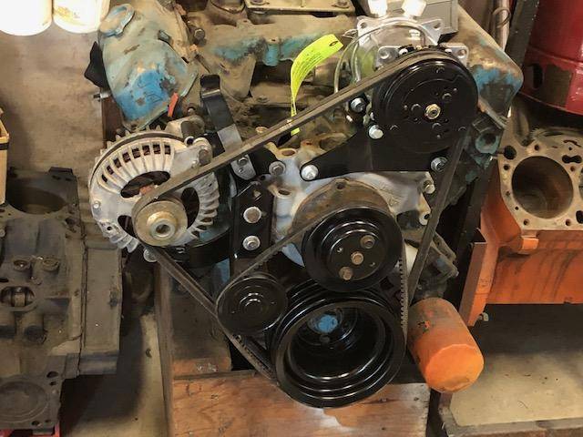

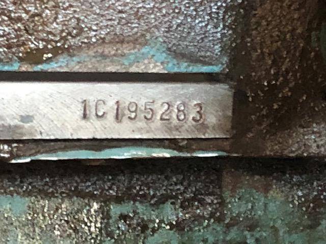

Turns out it is..... The first number (1) indicates 71 model year.... And the (C) indicates Chrysler....
I think the "c " means Jefferson Michigan assy plant. I don't know exactly what they built there, but it sure could have been 300s. Agree the 1 means 1971. I think you have the original engine. Just looks like the block was cast for a 70 assy, but sat around for a while.
Thanks!
View attachment 921227 View attachment 921228 View attachment 921229
11/11/69 is the casting date of that particular part. 2586480 is the part number for the engine assembly. Who knows what the -7 means. It could mean nothing beyond the needs of the plant staff. 1C195283 is the last eight characters of the VIN of the car in which the engine was originally installed. The car was a '71 built in plant C whichever one that is, and 195283 is the sequence number from the VIN. The car in question was the 95,283rd car of that model built that model year, and was likely a fairly late build. So the engine assembly or just the block was hangin' around for a couple of years before the car was built. An engine hangin' around for a couple of years helps explain why there were big blocks still painted corporate turquoise (like the engine in question) a couple of years after the company had adopted corporate blue for most engines.
When we are talking about numbers matching cars, that ID appearing on the passenger side oil pan rail must match the last eight characters of the VIN of the car in question. Those eight characters will also likely appear on the driver's side trunk opening rail under the trunk weather seal, on the cowl under the hood weather seal and possibly in other locations on the body. Those characters will also appear on a pad on the passenger's side of a manual transmission or on a pad on the passenger's side of the bellhousing of a TorqueFlite. If some or all of those numbers don't match, numbers matching goes out the window along with some or much of the value of the car.
