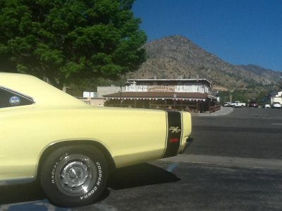

iPadApril2014 1174.jpg 295 15's. Eight inch rim.
do you know what your backspace is please Dennis?
