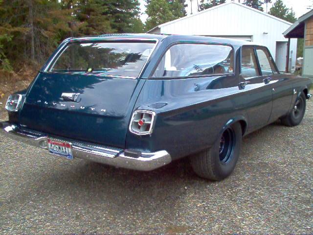

My only early-B Mopar steelie fitments are on '63 & '64 wagons; 7s w 255/70s had plenty of room but 8s with 285/70s (photo) were tight, and that was after I'd narrowed the rearend a bit.
